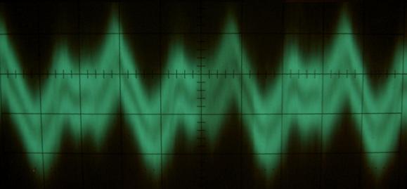

Here's an example of 60-Hz hum:
I had a better example that looked like a sine-wave with 3 or 4 additional sine-waves on top of it all at different frequencies but cannot find it now.
