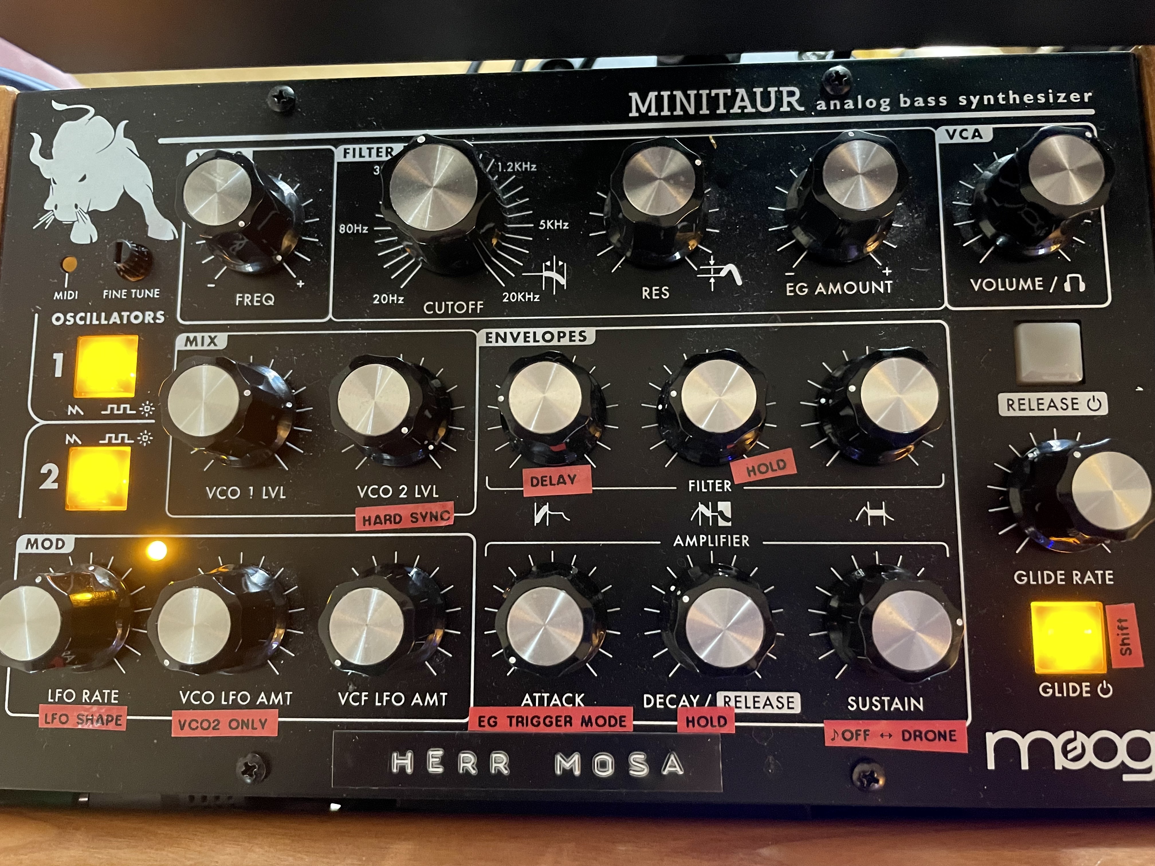

I did put on some stickers of some hitten functions i can't remember for live use.

The editor still works fine for me on Windows 10 too. I’ve had some issues with the Preset Manager on macOS Sequoia, but nothing that stops me from editing. Still usable. I even added a few stickers for hidden functions I tend to forget during live use — makes it quicker in the heat of the moment.Herr Mosa wrote: Wed May 28, 2025 1:17 pm The editor is still doing fine in Win10. I Have "some Issues" with the Preset Manager under Mac OS Sequoia but i can still edit.
https://moogmusic-help.freshdesk.com/en ... load-links snow rider

Interesting note about macOS Sequoia and the Preset Manager — hope they patch that soon.
Also, nice idea with the stickers for hidden functions! Might borrow that trick for live sets.
