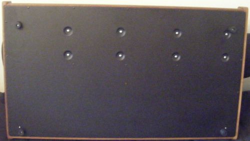

I've learned to distinguish between the chinese from the Fatar is simply to look on the base plate. If there are 8 screws it is the chinese one. If there are 10 screws the Fatar is implemented.
The following pictures shows the chinese version.
