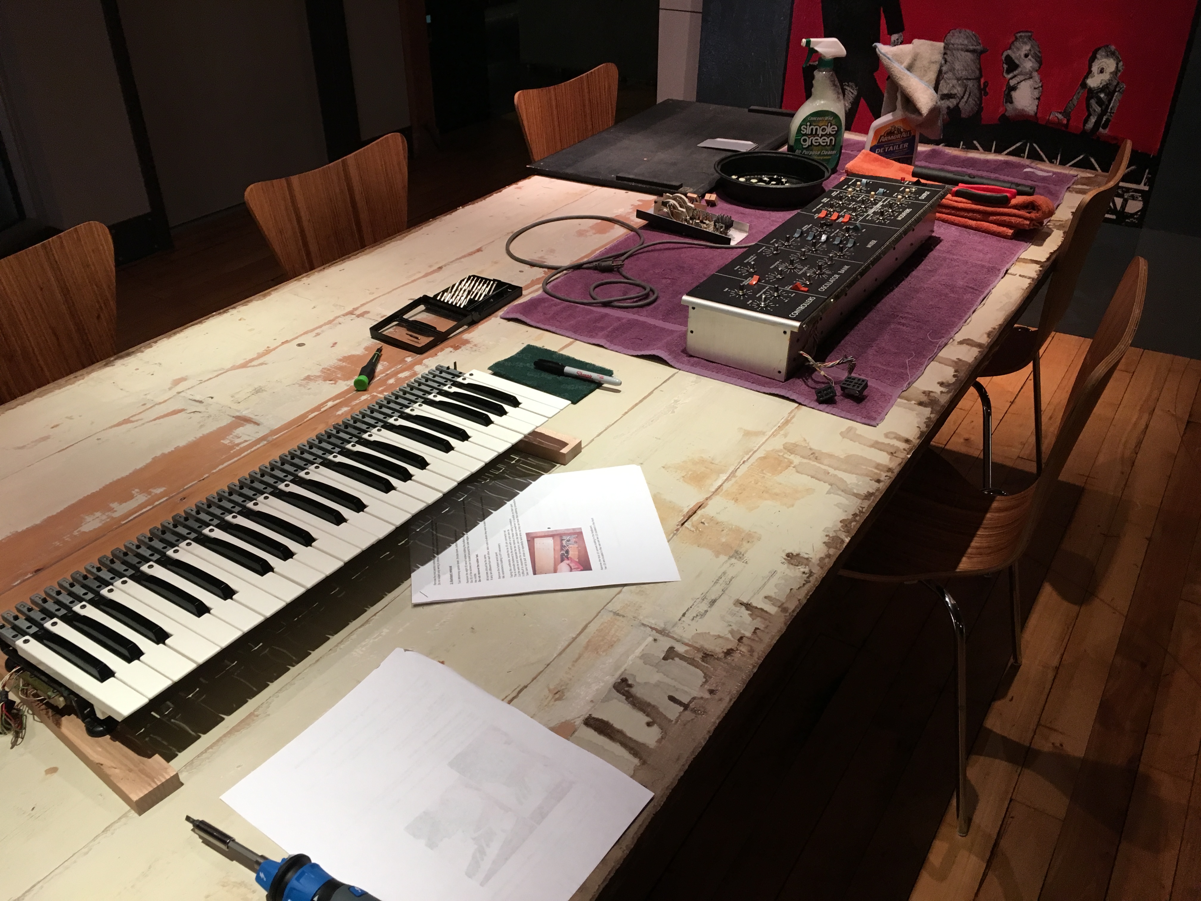

I finally received the Moog! It was packed very well, but I immediately noticed that something was rattling around the inside of the panel. Turned out a screw and an insulated washer holding one of the boards had fallen out - the other screw was totally missing. Nothing serious. Some of the keys still don't work like they should, and I still can't get the modulation to work right. I've already emailed them and they asked me to test it more - they have been very receptive so far. Considering this is my first Minimoog, there could be a lot of user error here. I really don't want to send this thing out again, especially after having it gone for over a month, and I'm very anxious to refinish the cabinet and get this thing proper again! Here's a video showing the bad keys and faulty modulation:

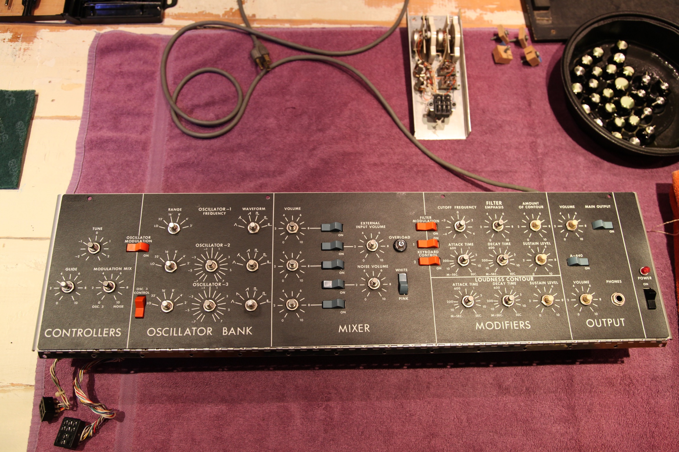

Alain - Thanks very much for that info. I had a feeling it was user error - I already have the entire unit completely apart and removed from it's case so it can get refinished. I may try hooking up the unit out of it's case and testing that know that I have the right info.
Yes, I'm very sad it cost this much to fix and it's still not right, but if it can all be solved by the opto-key, I will be doing that myself ASAP. Now that I know the rest can be resolved on my own (hopefully) I can begin the renovation process. Even though I don't intend to sell it, I'm fairly confident that I could probably get back what I have into it (which eases the pain a bit).
I'll be posting more pics of the process.
Again, thanks for the info. It's very helpful.

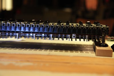

Watched the video, sad, sad, sad! I do a lot of MiniMoog's which is my primary focus, and this is about as bad as one is when it comes in; returning it as repaired to a customer like this does nothing for the vintage service industry or VA's reputation. Seems to me that they should either make this good at their cost, or give you a serious refund.
From the pictures during repair and the post repair experience I would say your key contact assy needs all of the springs replacing with new ones. They are not cheap and of course have to be fitted correctly which is a bunch more labor and needs to be done by someone with the right skill-set. Some melted parts might need changing, and the state of the buss-bars is unknown.
I know you do not want to send your MiniMoog out again. Opto-key is a user install kit, but from the video you need other items serviced too.
I'm here to get your MiniMoog singing again if you decide not to move forward (backwards) with VA and want my help. As an option, if you wanted to remove the keyboard and send that to me while you refinish the case, or the whole unit (makes the most sense as I think it needs a full service) then that is doable.

Hello Chris - thanks for the reply! I definitely don't want to mess around with correcting the key contact issue - I plan on doing the opto-key mod myself. Shouldn't this correct all of the bad key issues?
Can you please explain why you think the keyboard itself needs work if even if I plan on installing the opto-kit? Also, what else did you think needs servicing aside from the bad keys?

Shouldn't this correct all of the bad key issues? Per Alain's reply, yes, as long as it was re-bushed and the bushing posts were correctly aligned by AL. Download the install doc from my site where it details the action. It is not a difficult install as long as you have the manual skills. Having taken the mini apart I think you do!
Can you please explain why you think the keyboard itself needs work if even if I plan on installing the opto-kit? Also, what else did you think needs servicing aside from the bad keys? I was referring to switch and connector contact cleaning on the main unit, along with cleaning the pins on the modulator panel connector. I do a lot of reliability/ stability things like changing op-amps, replacing the cronky osc card pots with multi-turn ones, wiring in the unused second halves of the range switches, fitting the Moog factory pitch centering mod, and more.
I think you should get the basics done and install Opto-key, then see if any of these other things gives benefit.

Spumoni wrote:Just got an update from Analog Lab - they got everything working much better, had to cut open the pots the clean them which helped tremendously. They were having issues with the key contacts, and had to remove the board a second time and solder each and every contact. He said for some reason, the existing solder was not reacting like normal. But now that it's entirely been redone they think it will last a long time. Hopefully there won't be many more issues...
