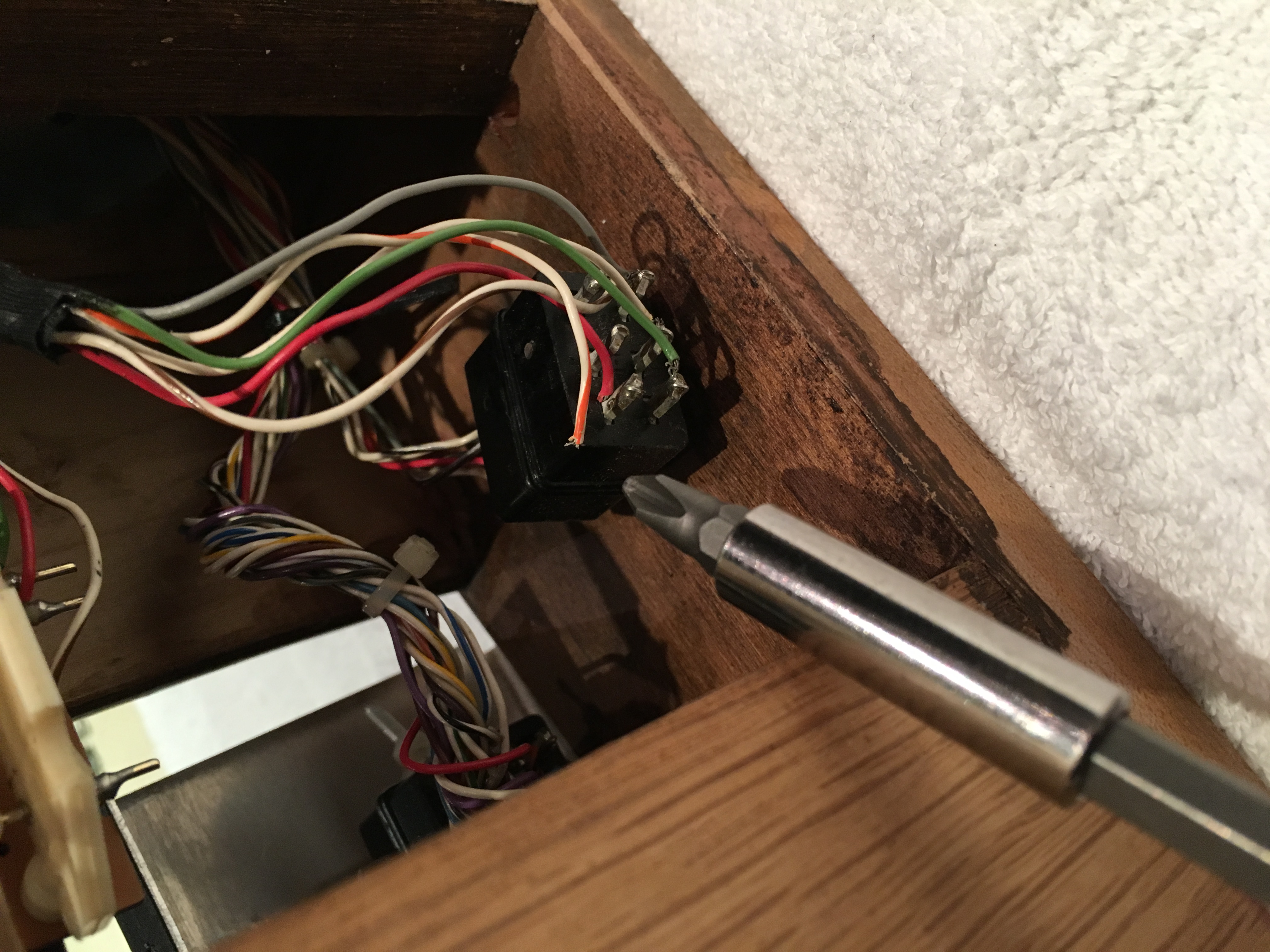

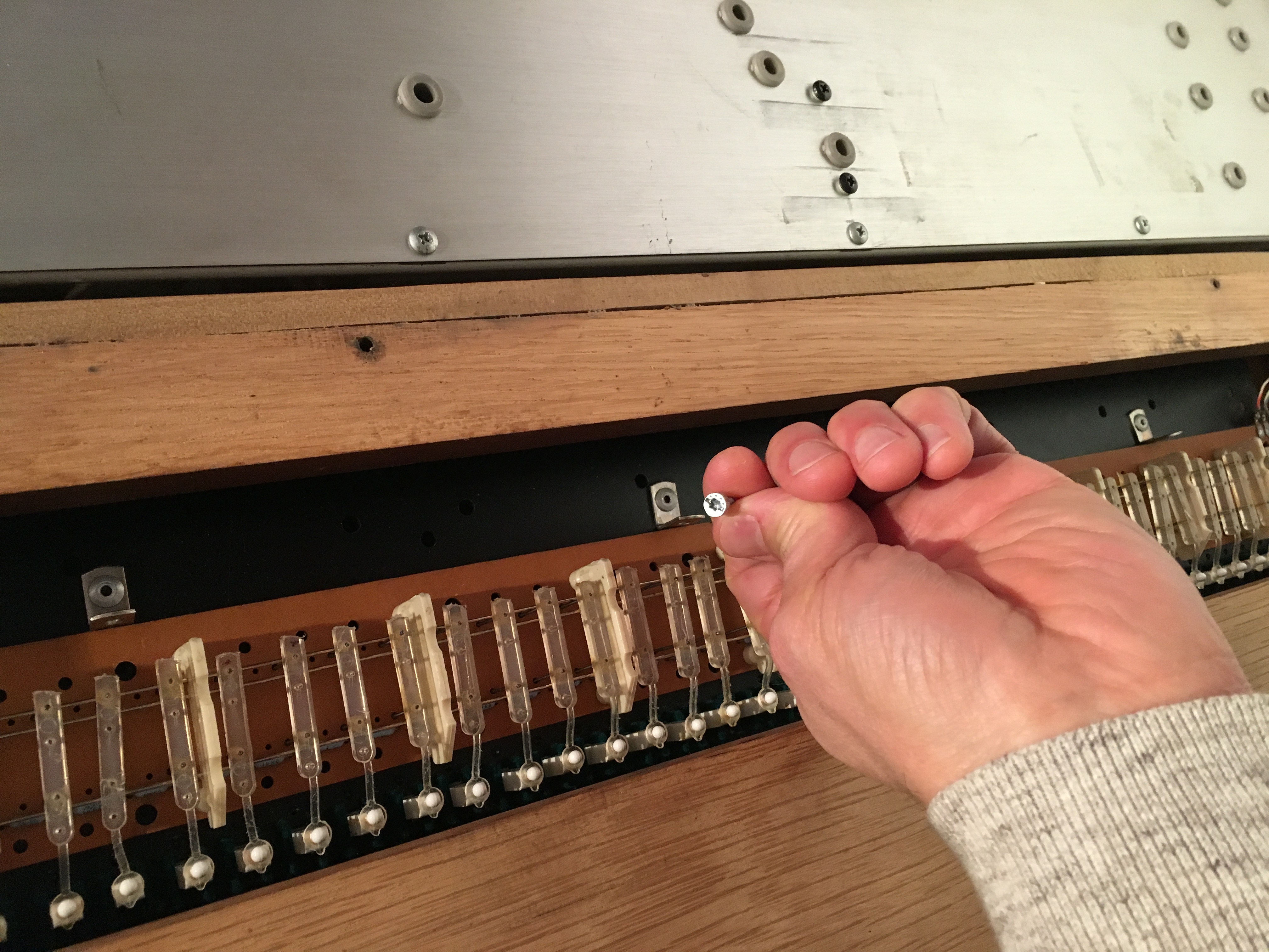

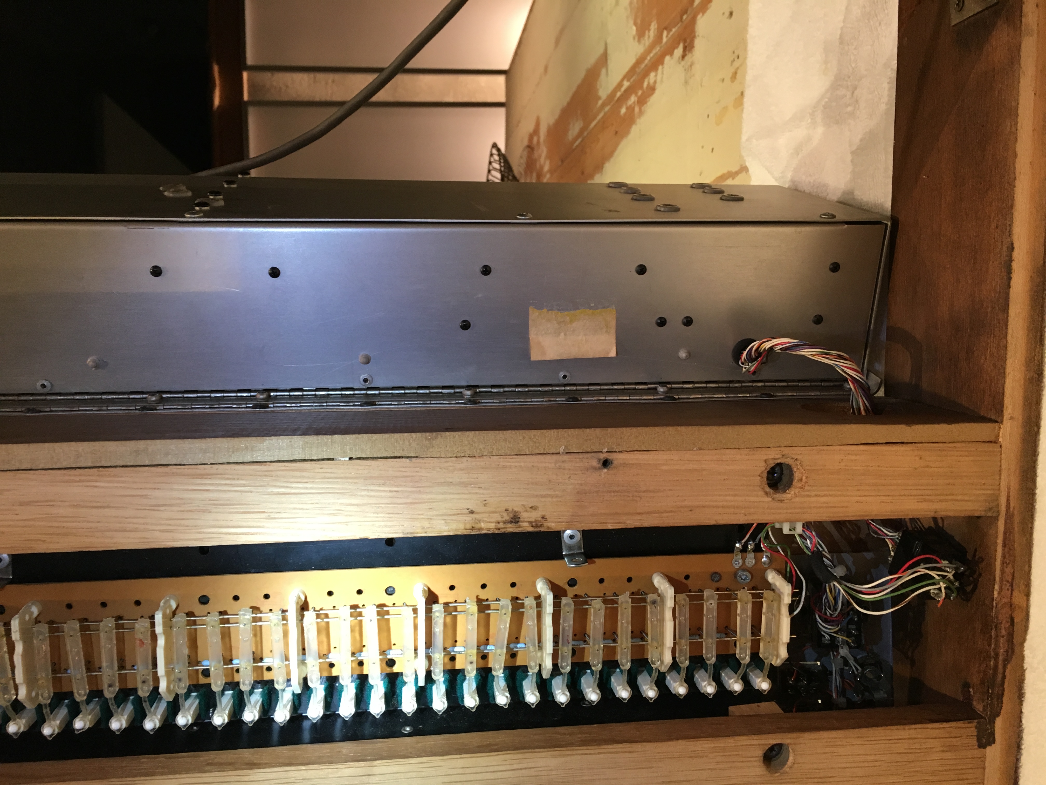

The Moog finally arrived yesterday, and needless to say I was delighted with the condition! The seller did a fabulous job of packing it, and the condition was better than expected. I removed the back panel before turning it on, and it appeared spotless and untouched. I tried plugging it in, and was not able to get any sounds. I could hear some faint oscillator sounds, but they were not effected by pressing the keys. I unplugged the unit, and removed the bottom panel. I found 8 matching loose screws, and the entire long board under the key bed (that has those wire rails and clear rubber things) was totally loose. I also noticed the wire connector coming from the keyboard had a broken solder connection. As soon as I touched it, another wire broke off. Hopefully this will explain the keyboard not working.
I'm waiting for my coworker to solder those wires back on, and hopefully that will solve the "no sound" issue. But in the meantime, when I tried putting the loose screws back in, they didn't feel like they were screwing into threads. It felt more like they were screwing into foam. Although they will probably hold the board on, this didn't seem normal. I will remove the keyboard today and investigate further.
Does anyone know the correct screws to mount this board?

We got the wires soldered back on to the connector, but it worries me that the wires aren't matching on both sides of the connecter - I would assume it should be the same, but it appears as though a couple were switch. Either way, the keyboard now works, and I'm getting a tone! A very ugly tone, but a tone that responds to the keyboard!
I didn't have it one for more than a few minutes, but it really sounded pretty bad - oscillator 1 was really screechy, and I couldn't turn the sustain of the notes, but again I was rushed. Hopefully it's user error, and nothing serious. I will spend more time with it tonight.

Spumoni wrote:I found 8 matching loose screws, and the entire long board under the key bed (that has those wire rails and clear rubber things) was totally loose. I also noticed the wire connector coming from the keyboard had a broken solder connection. As soon as I touched it, another wire broke off.
This sounds pretty bad.... the "entire long board" is basically the keyboard contact assembly and it needs to be fastened, not only securely but also at the correct distance - from the keyboard actuators..! The whole board is/was originally held onto the frame by rubber 'cones'. These
'cones' deteriorate and cannot be sourced any more. My guess is that this Mini has had some work done to get around this problem. It might account for the loose screws..?
Either way - until you get that board mounted securely and in the correct place you can forget trying to "play" the keyboard I think.
The wire breaking off is no big deal... I'd be more worried about that key-bed. Seems to me like you need a good tech to get this thing sorted...!
