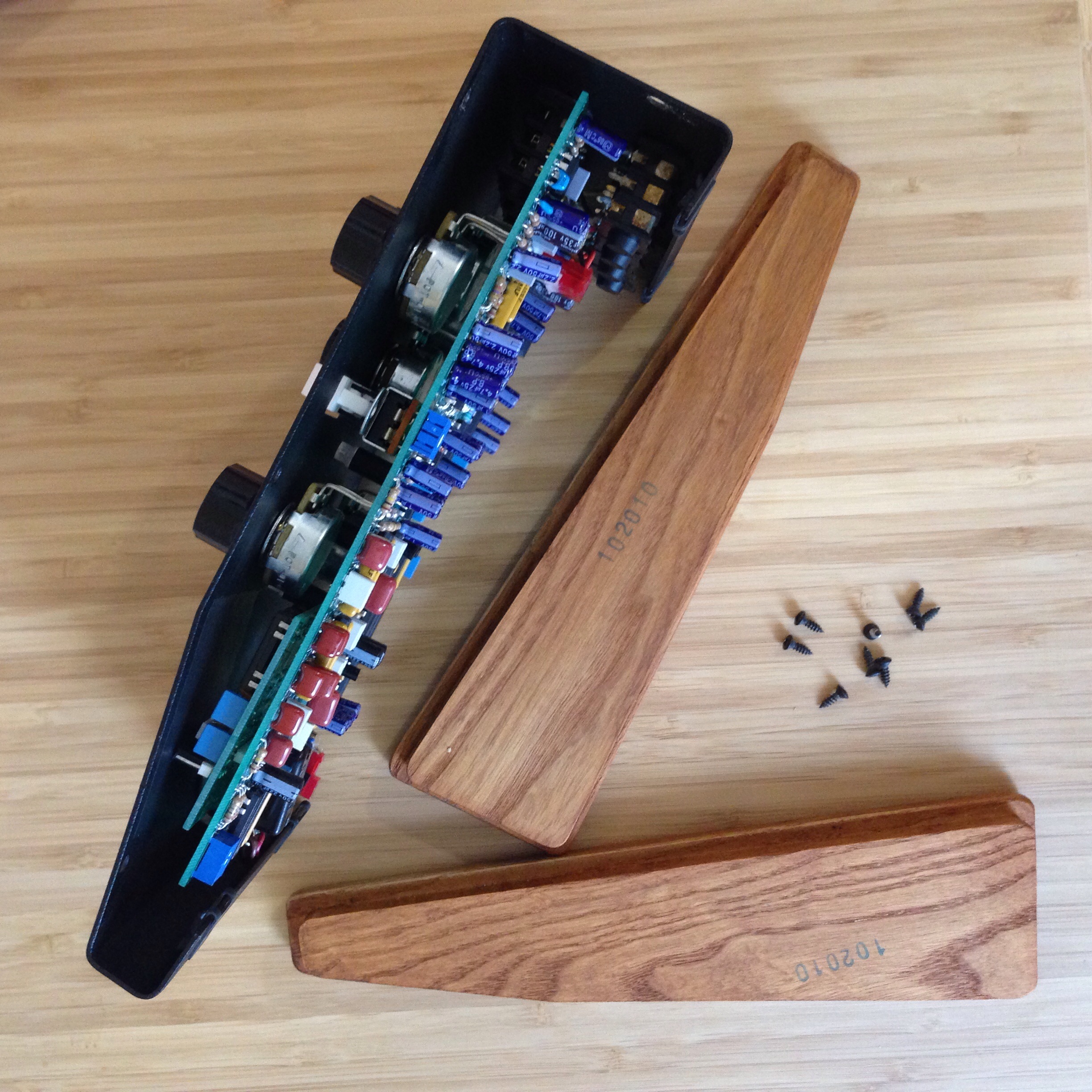

Re: mf104z no delay out

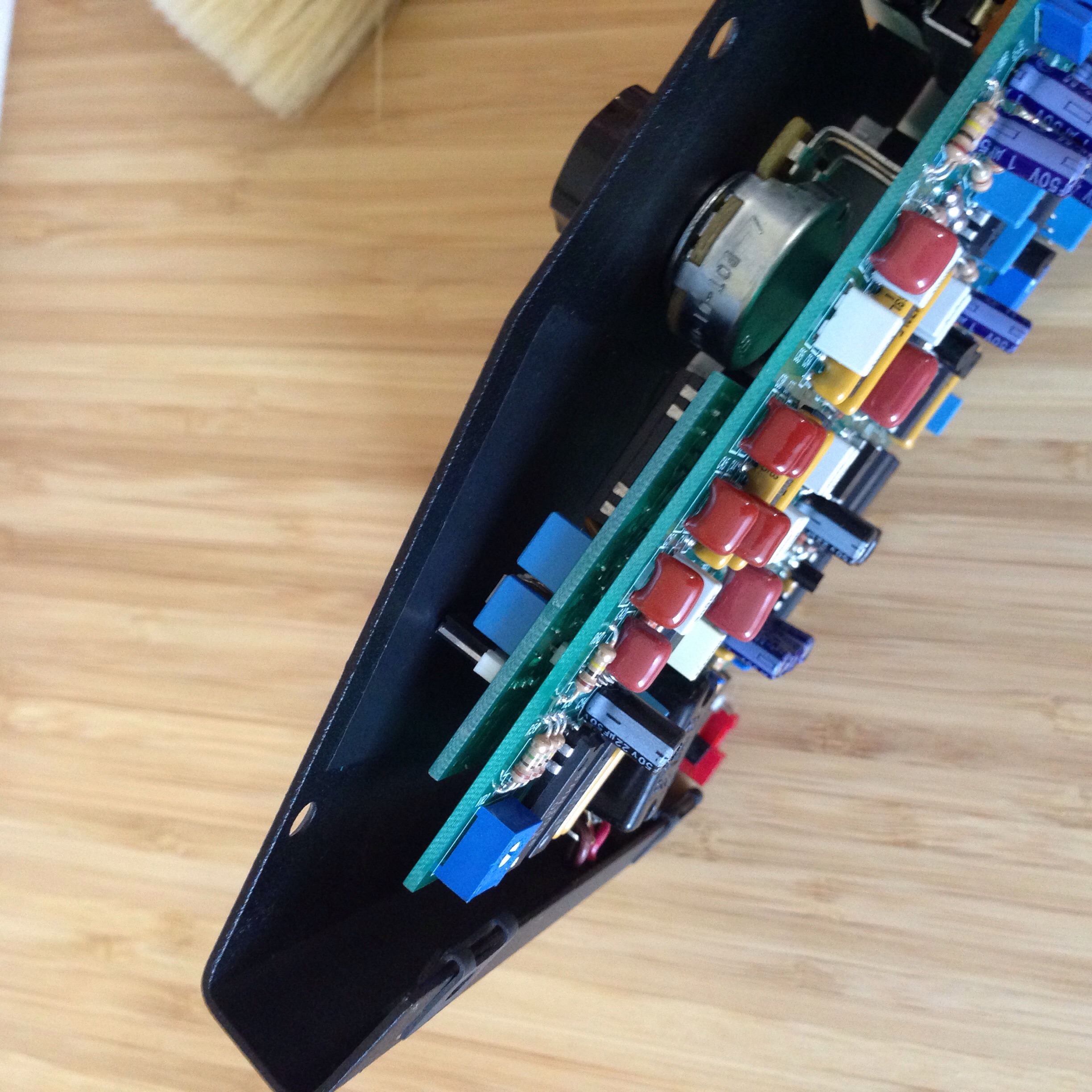

You can't see it from the bottom, only the side.
There is a second circuit board attached to the motherboard, and there are jumper pins that extend from the top that touch the top of the chassis and short out. Even if it looks like they don't touch the top of the metal, they get close enough to create a short (electrons can jump a good distance, thanks to Einstein's revelation) Those pins must be clipped, insulated or covered to keep the delay from shorting out. Paper is only a temporary solution as it will degrade away. Electrical tape, or clipping and covering them in the answer.
Oh, thank's a lot!Croyote wrote:You can't see it from the bottom, only the side.

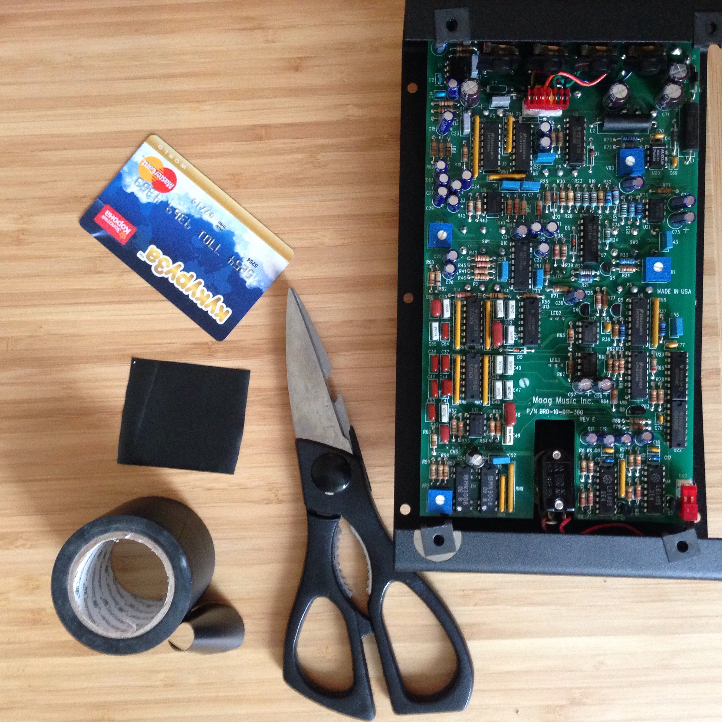

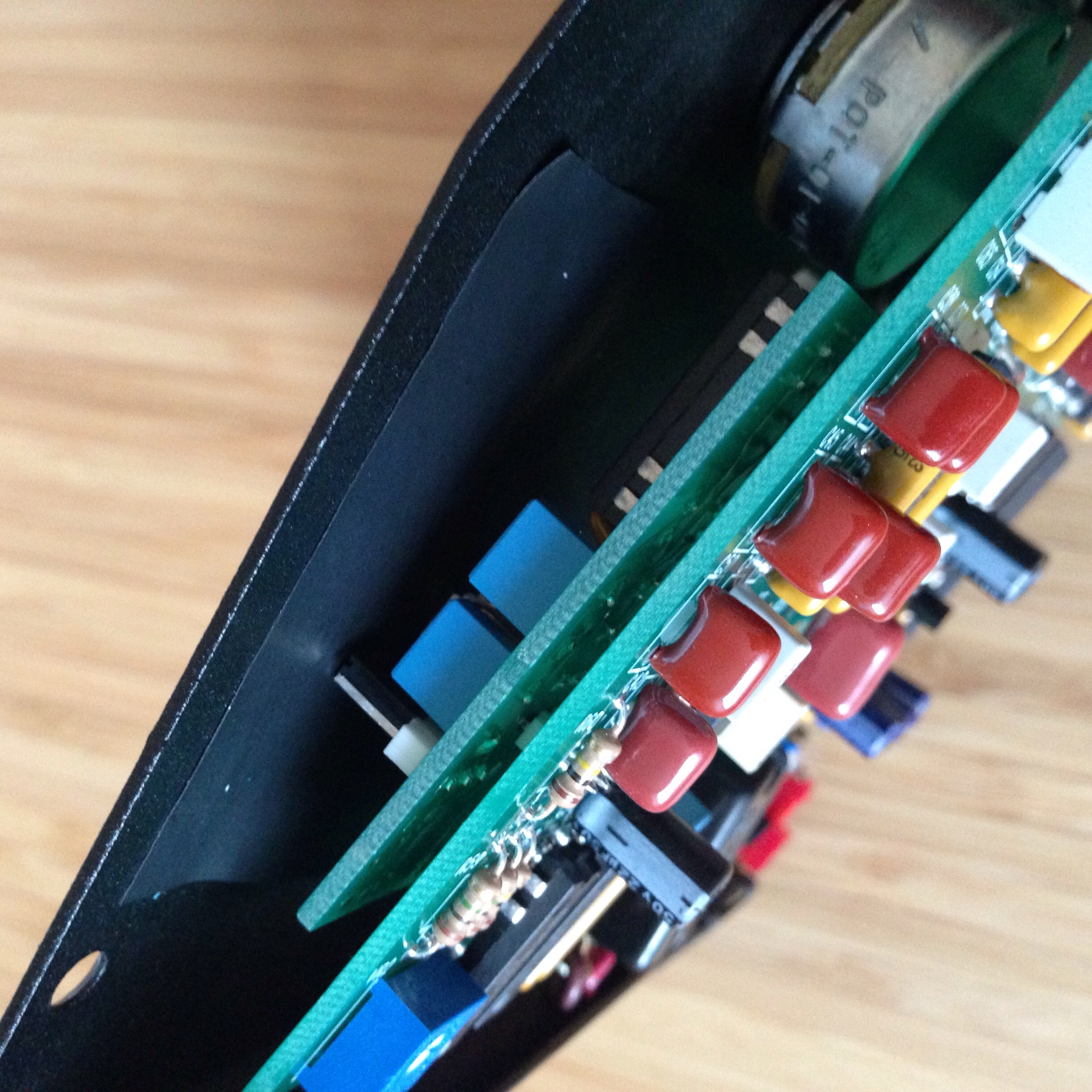

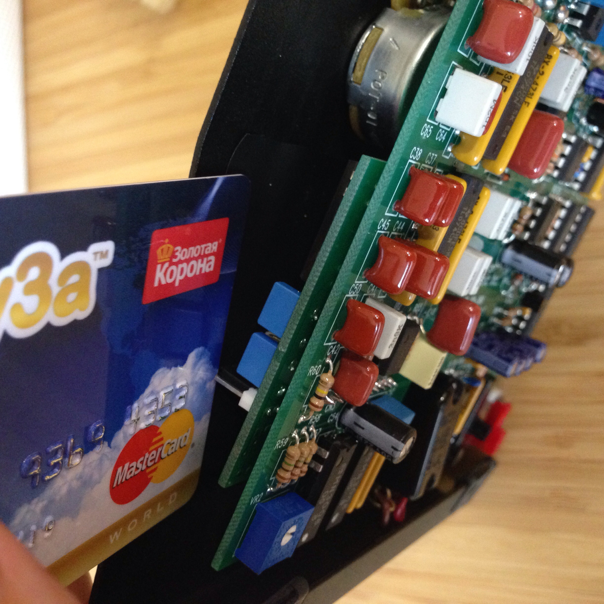

That's what I did now:
Voyager PE, VX-351, 2xCP-251, LittlePhatty SE II, MF-101, MF-102, MF-103, MF-104M, MF-105M, MF-107, MF-108M
And that's what I got:
Yep, I installed some plastic card pieces wherever some parts could touch the plate. It worked... at first. Then, two days ago, it did it again. I opened it to check, everything seemed fine. Closed it, still no feedback. And yesterday, it worked again.
Weird :/ I only use it at home for rehearsing so it's not that bad but weird.
