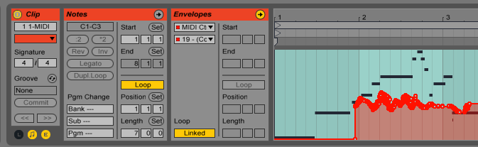

I don't have another DAW to compare, but my other synths work fine (Analog 4 for example.)Regarding the first notes of a pattern in Ableton Live not playing sometimes... is it possible this is an Ableton-specific behavior? Do you have any other MIDI-sending software or DAW you can compare? Alternatively... do you have any way to capture the MIDI output from Live when you start playing a clip? I am wondering if Live is maybe failing to send the first note-on sometimes.
Here is how to recreate this problem - you record the notes and tweak the knobs for automation at the same time during recording.
I have a video of this problem, please check it out here. Seems like the problem is, it failed to send knobs information to DAW for the first few seconds.
http://www.youtube.com/watch?v=mX_eDHmipsw
If you do it separately in 2 takes, it will do fine. (First, record the notes in 1st take, then record knobs automation in 2nd take.

OK I tried the same thing and got a similar-looking result.tungchihyu wrote:Here is how to recreate this problem - you record the notes and tweak the knobs for automation at the same time during recording.
I don't think it's the Sub Phatty though...
I think when you record a MIDI clip in Live, and the first MIDI CC message comes some time after the start of the clip...
Live puts a "zero" CC value before the first real received CC value.
Thus when you play back the clip, Live will output a CC value zero (filter all the way at zero, if you were recording filter cutoff CC) from the start of the clip until the first real CC value you recorded.
The quick answer is to go into your automation after you record and simply delete the first zero-value CC messages from the start of the track.
Again, the synth is not really sending a CC value zero when you start recording; it sends the correct starting value based on the current parameter value / knob position, when you start turning knobs and recording MIDI.
It's Live that is adding the zero-value at the beginning...
I will ask my friend at Ableton if this is correct or not.
