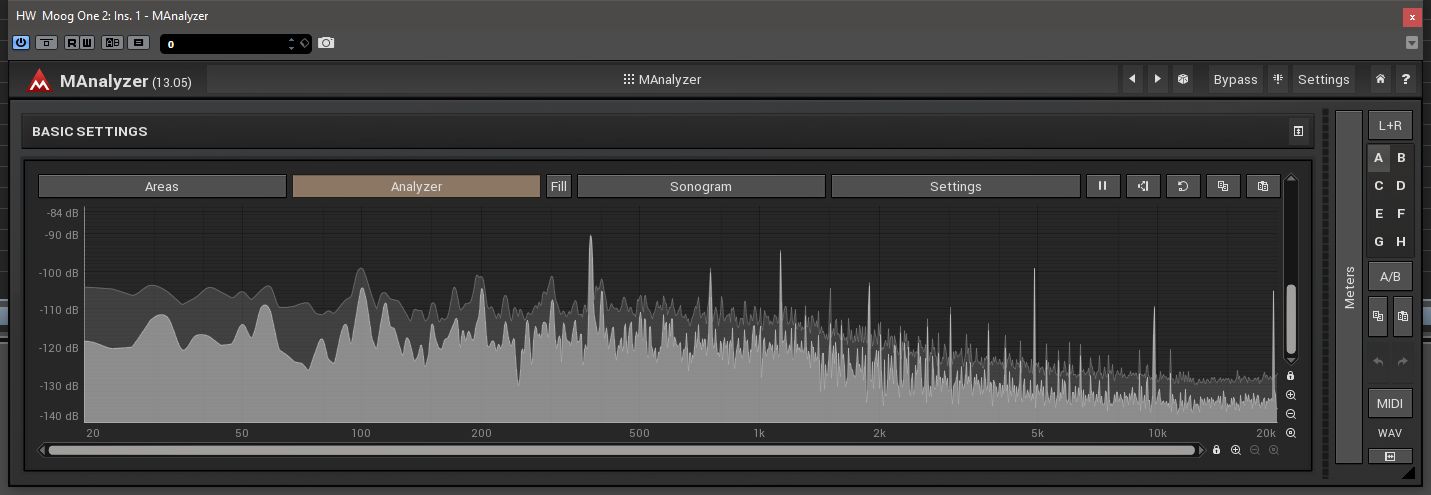

However, meanwhile check out the noise of my sub outs :open_mouth: And nope, that’s nothing from outside. I disconnected everything else, the powerlines are clean and no other unit behaves like this.
