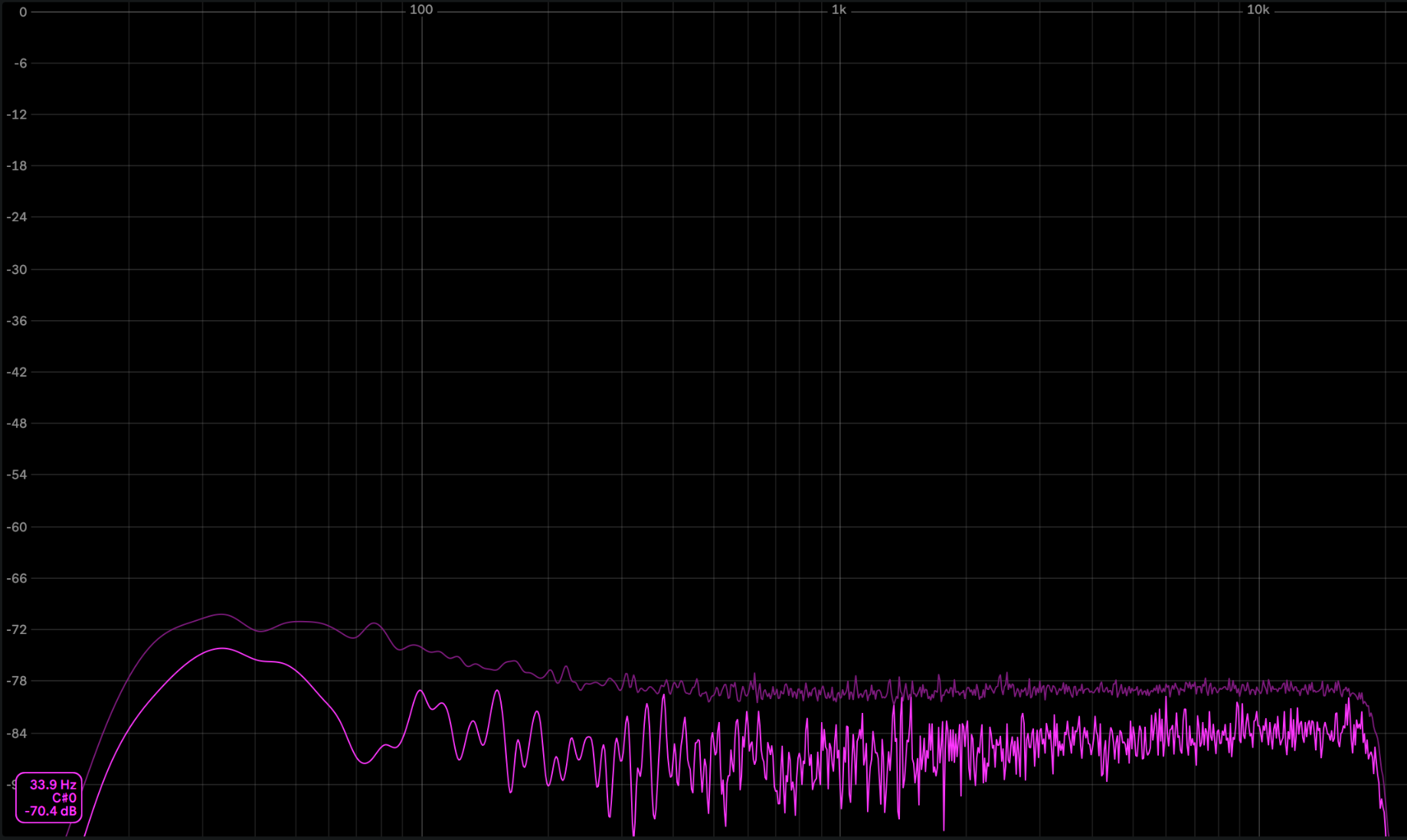

For comparison reasons i’m providing this info:
- Moog One 16 voice, patch level 1.4.0
- Ableton Live 10.1.15
- Steinberg UR22 mkII Audio Interface
- Klotz B4PP1-0300 (Neutrik jack) Balanced TRS audio cables
Oscillators disabled in the mixer, VCA at 100%, Master Volume at 100%
As you can see the peak is at -70.4db @33.9hz

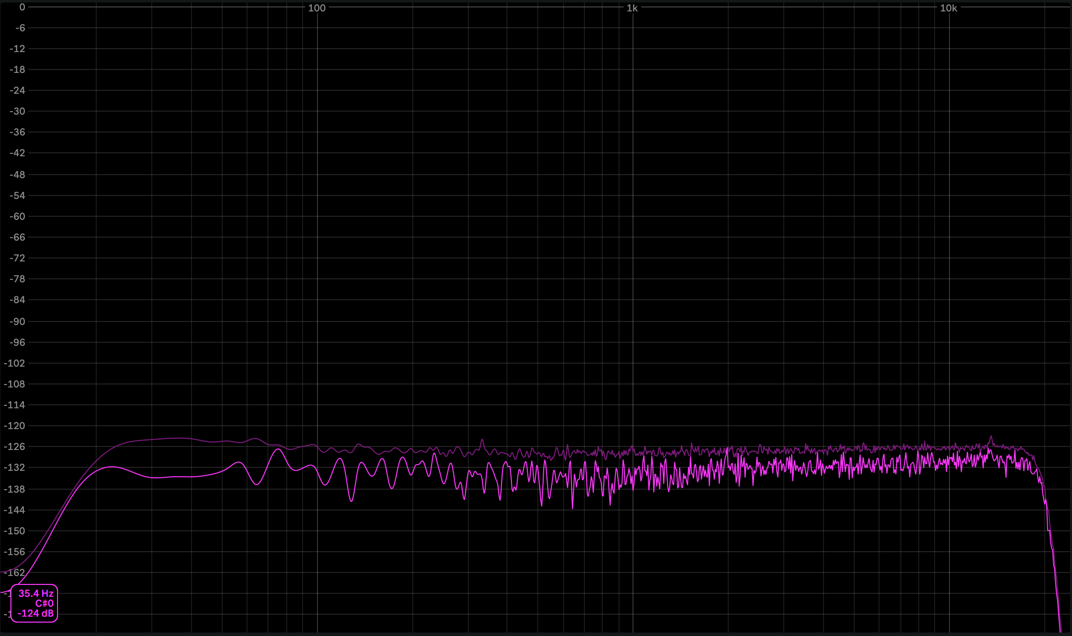

For reference, normally the peak in the noise floor of the Steinberg UR22mkII is at -124db:
instead of the master volume at 100%, I would suggest taking the measurement again with the master volume at 50%.
This would reflect unity gain and be more representative of how folks actually use the synth. Anything above 50% starts to degrade the sound and raise the noise floor rather significantly.
Ok - i’ll have to crank up the input gain on the UR22 to compensate and maintain input level (-6db when playing INIT chord) - will do the measurement again.
