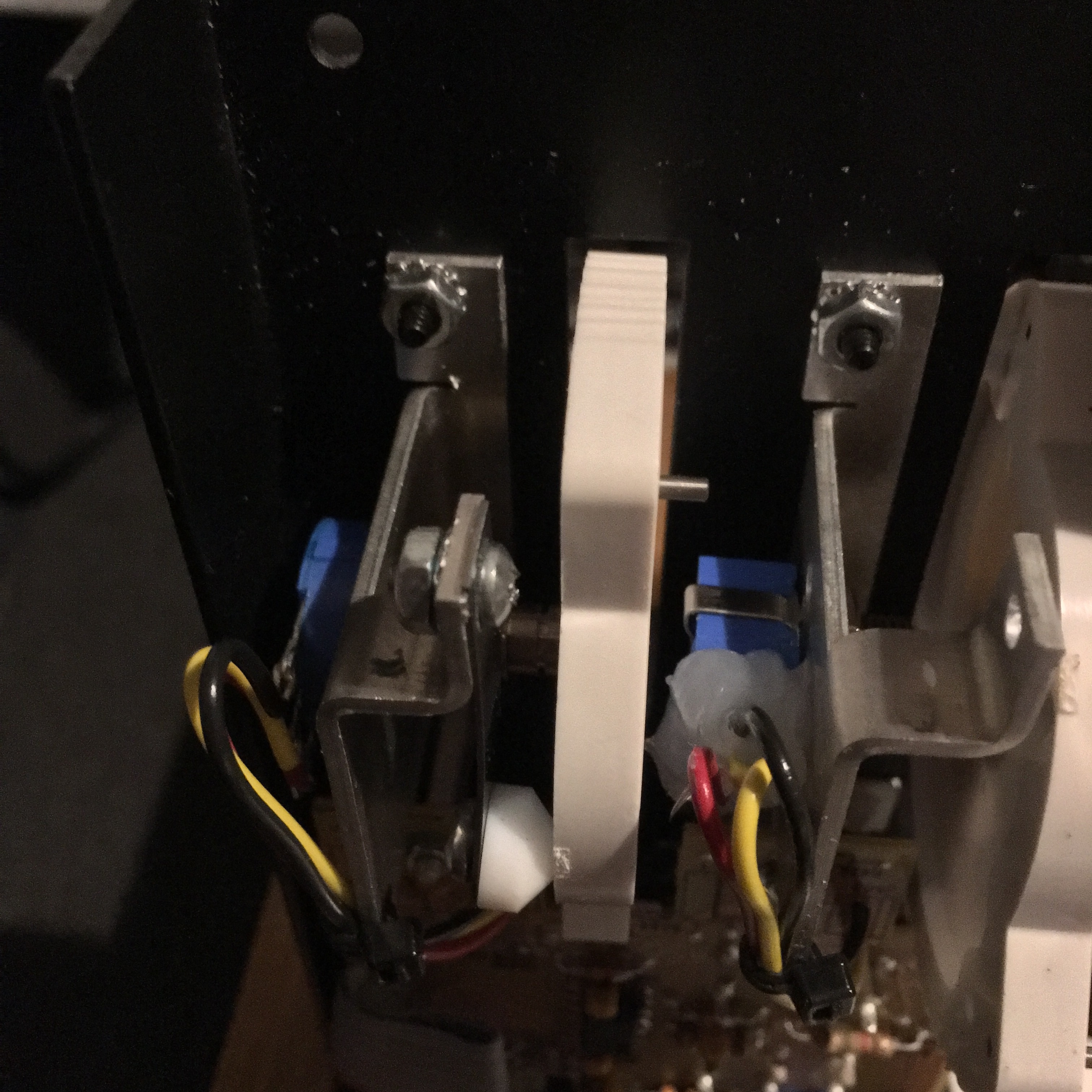

I just installed the MUSE on my reissue. Works fine. But you need to some technicsl experience. But no soldering needed.
And while I had the left section open, I get rid of the nut between the wheel holder and the tongue with the cone used to hold the pitchbend very tidt into the center possition. Now it isn‘t that stiff anymore. And still no random MIDI values sent in zero position.

It is not easy to do, as the ribbon cabel that reaches from the panel through the hole to the left hand section is not that long enough to just undo the left hand section. Also the vulnerable ribbon cable of the aftertouch is to short. And the digital interface of the Minimoog reissue handling the MIDI is below the keyboard action and also connected with a ribbon cable to the left hand section.
But I had to disconnect these three cables anyway to install the MUSE board. So this little pitchbend modification was just a spontaneous idea while having the left hand section in my hand.

till, thanks so much for the picture. i installed muse a couple of days ago and decided to reopen my moogie again to ease the wheels stiffnes. your hint helps a lot and the wheel feels quite “organic” now. from day to day i love my minimoog even more. :smiley: thanks again.
