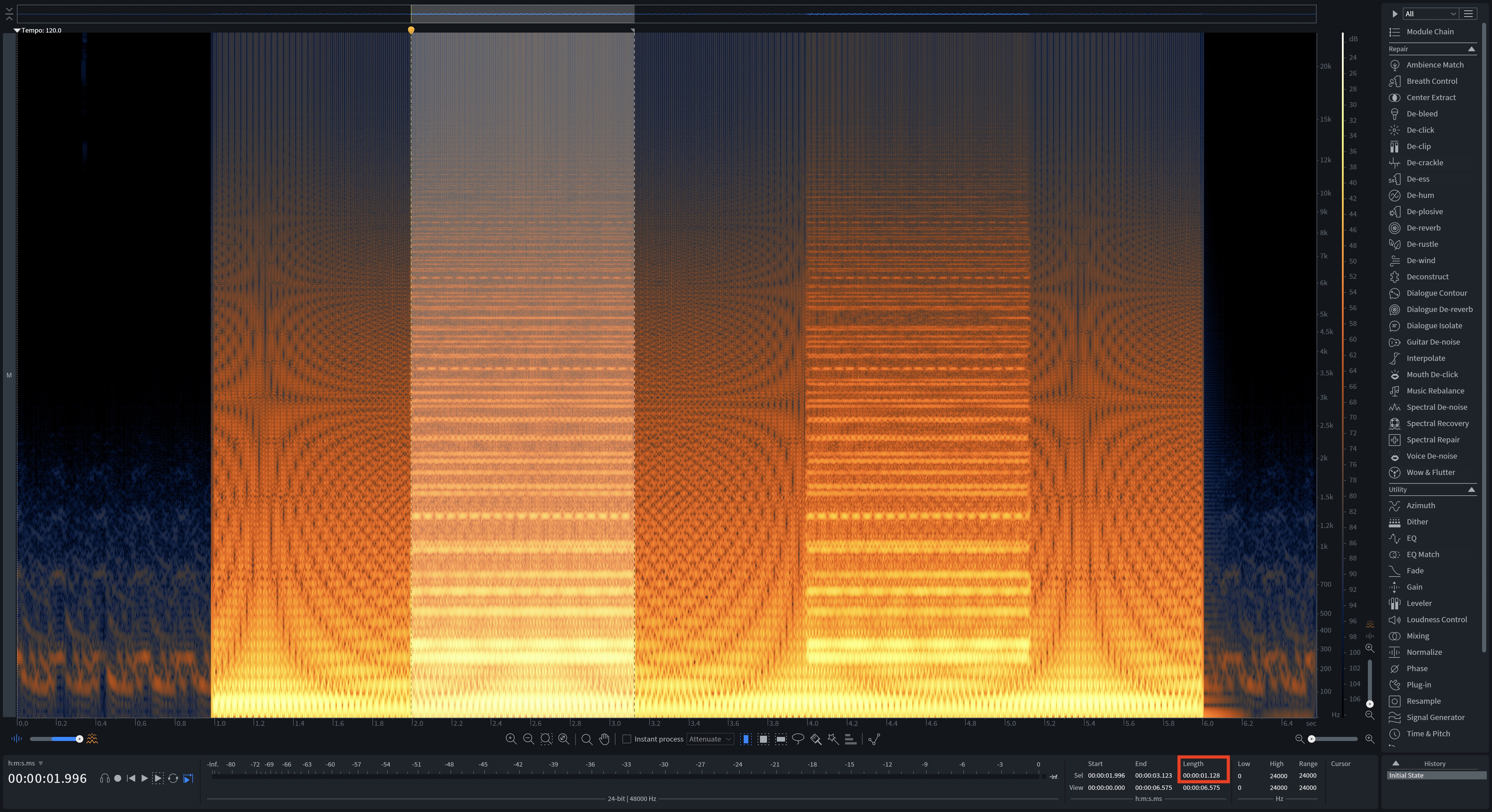

I’m filming my video now. In the interest of being scientific, I decided to measure the internal gate lag. Assuming normal gate operation has near-instantaneous release — ±5ms or so, similar to the main VCA attack and release — we should be able to assess how long the lag is.
I sent MIDI notes from Logic: a 5-second C1 and C2, with two one-second holds on C4 and E4 every other second. I recorded Matriarch’s output and analyzed it in iZotope RX. I zoomed in carefully to get as close to the actual notes as possible, but consider human margin of error at ±1ms for my numbers.
You’ll notice that my selection is 1.128 seconds long. Yes, internal gate releases have 128 milliseconds of lag. Even if they’re not instantaneous, they should be at most 5 ms, the same as the VCA, no?
I’ve provided a wav and midi (120 bpm) in a zipped folder if you want to replicate this experiment or analyze my file yourself, if you have better metering tools. I think Logic may have compensated for latency since the onset of the first note appears just before 1s.
Matriarch gate test.zip (855 KB)
