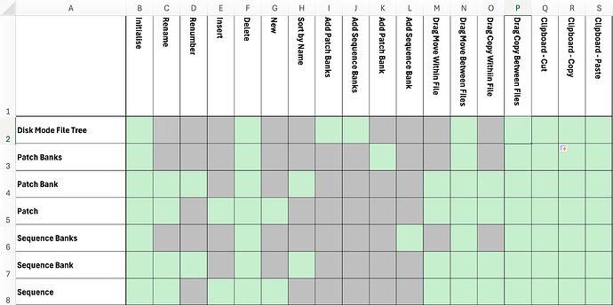

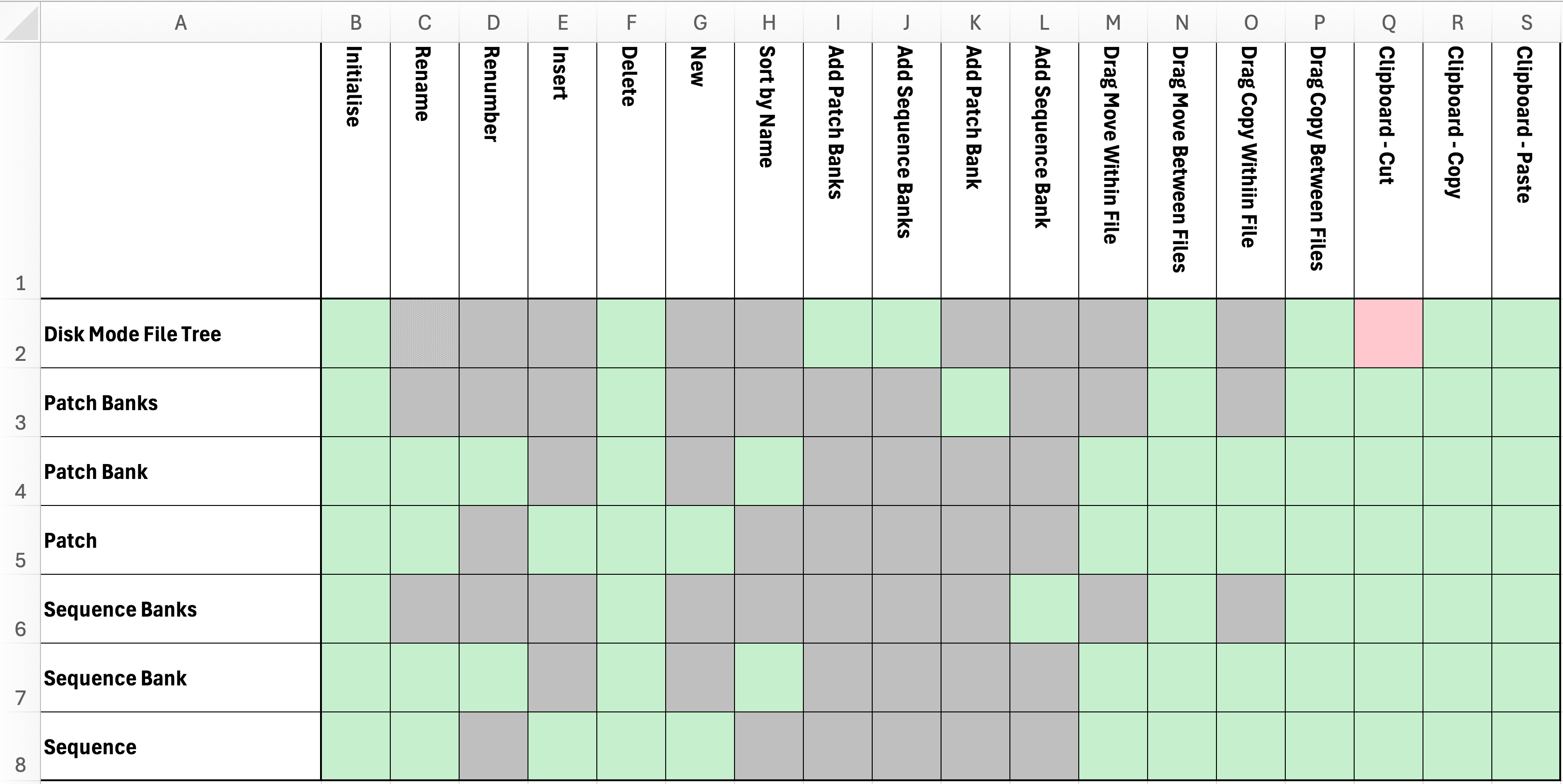

All features were tested over the weekend and are working with the exception of a problem with cutting (instead of copying) the top level of the directory tree. For now I have disabled the clipboard access at the top level and logged the issue (as it was not looking to be a five minute fix). You can still use the clipboard to cut/copy and paste as an alternative to drag and drop below the top level of the tree. I am a little baffled as to why I have the issue right at the top level.

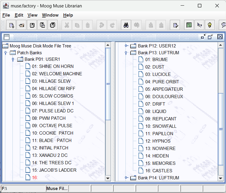

I then got brave and tried to see if I could “open” the Muse disk mode drive directly in muse.factory. It is a little slow, but it appeared in muse.factory - see below. Drive F: is the Muse Disk mode drive mapping on my Windows DAW PC. And you can see my initial Muse patch programming efforts have been recreating some classic progressive rock sounds, if you are familiar with the song titles!
