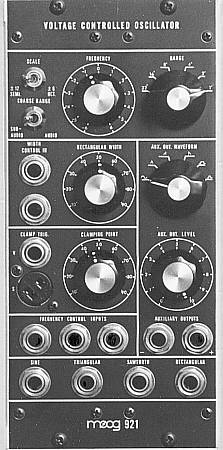

The MOSLAB modules probably more closely resemble the modules than any other Moog clone that Ive seen so far. THe dotcom Oscs are loosely based on and resemble the 921 to a degree but I think have an extra waveform.
THey are a little more expensive though and I don't know what makes the actual circuit different.
THe Modusonics, we have determined are the closest to actual original designs because they are based purely on the original designs and use original parts. THese cost around 700 though and I don't have a picture of those, just pictures of my 921b.

To reiterate...Synthesizers.com oscillators do not require the oscillator drivers, and are quite affordable, and are also very stable with the stability upgrade...probably the most stable on the market.
MOS-LAB's require a driver, which greatly adds to the cost, but retains Bob's original design.
Modusonics are the most expensive, but are exact replicas of Bob's design and utilize the same components as the original modulars.
Oakley's design has a board that ultimately will be discarded. It's an interface board for their own modulars. You'll be paying for something you'll never use, although their core oscillator design is similar to the .com's. Using this information, you'll be able to make an informed decision. :wink:

Maybe I'm mistaken but I was under the impression that while the 921B ocsillator design requires the 921A oscillator driver module (no matter who makes one: Moog, Modusonics, Mos-Lab or Club Of The Knobs etc) the straight 921 oscillator does not require the 921A oscillator driver and works stand-alone. Is this correct or not?
Just FYI for the original poster: I've heard great things about the Oakley VCO but it's stability may be matched or even exceeded by the Synth Tech MOTM-300 VCO. (I have several MOTM-300's and they are GREAT! 8) ) But while both of those have panels that are the same height as Moog panels, they are a little narrower and the mounting hole spacing is different. Also the layout and graphics aren't the same as the Moog style. If you want to put these into a Moog case you might want to at least get some blank panels from synthesizers.com, drill and silk screen/label them and transfer the gutz over.

The 921 Osc does NOT require a driver as it is its own unique element.

Can anyone please explain why there are two different Moog VCO "types"? Was the 921A+921B(s) just a more economical solution than having a bunch of 921s or?
Will a 921 and 921A+921B pair sound pretty much the same or are they completley different?
John L Rice
Kevin Lightner
Posts: 1587
Location: Wrightwood
Post by Kevin Lightner » Sat Feb 28, 2009 5:49 am
John,
A 921 basically IS a 921A with a 921B together.
The boards to both the A & B modules are contained in the 921.
There's no difference in the sound between the two configurations.
The larger 921 has a mixed bi-polar output that's a bit hotter than a 921B delivers and the sync has some minor changes between the two, but otherwise they're pretty much the same.
