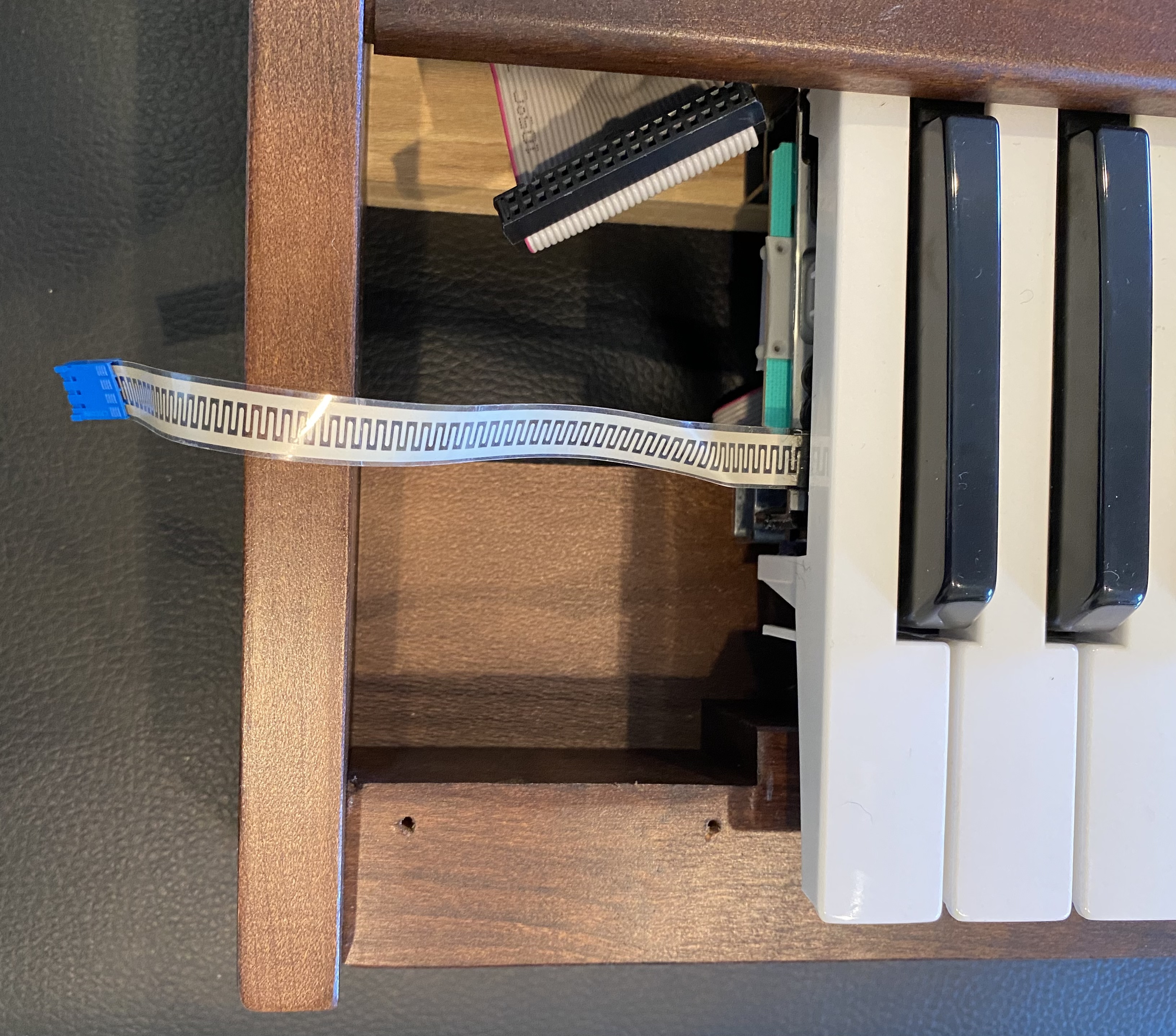

1) The keyboard issues: It is hard to assess the cause of this issue. There might be a bad batch of Fatars, but it is also possible to be a chassis-interference issue that pops up in shipping. Hopefully, Moog will get to the bottom of it. But, I’m am almost sure the spongy F-key is not a “known issue” related to the design of the aftertouch ribbon being too short. The left-hand controller in the 2022 re-issue has been totally re-designed, and the AT ribbon is generously long:
