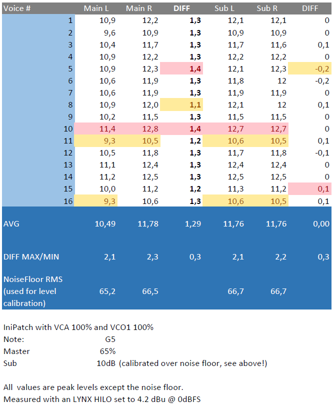

Yes, this is a buggy synth. On the other hand, it is great instrument in another, quite special way. Moog must have been close to the financial limits with its development, so they decided to release it in a very early state. Dave Smith hardware is much more mature these days, but I also remember the 08... it was a similar game.
Anyways, I measured my outputs for another reason (R/L inconsistency), and they are far from being well calibrated. I hope that can be easily done, preferably with software, or at least by myself when unscrewing the One. I would not really like to send it in to get a unit with errors again. This is already my second Moog One.
Please see the table attached.
