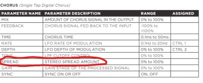

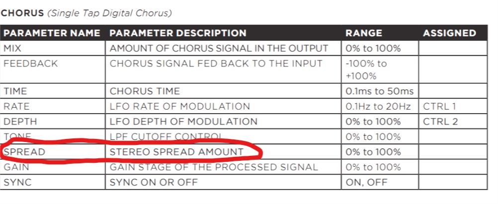

Post by TabbyCatte » Tue Jan 08, 2019 11:59 pm
Thanks for the input folks - I wasn't properly subscribed to the thread, so sorry for delayed reply!
PhilAiken wrote:
The stereo width parameter is not on the effects parameters page, but on the effect type page, and has to do with the relative panning of the stereo returns of the effects
I'm aware of the bus mode setting - I'm talking about the stereo spread in the actual effect algorithm:
That screen shot is from the docs. It shows you being able to adjust the stereo spread of the actual effect - but it doesn't exist on the instrument!
I'll give your various bussing suggestions a try though, anything to track down the combing I'm hearing.
_DemonDan_ wrote:
You are correct. The first round of Chorus and Flanger effects are monaural.
I see. Thanks for this - might I suggest updating the documentation? It made me partially crazy :lol:
