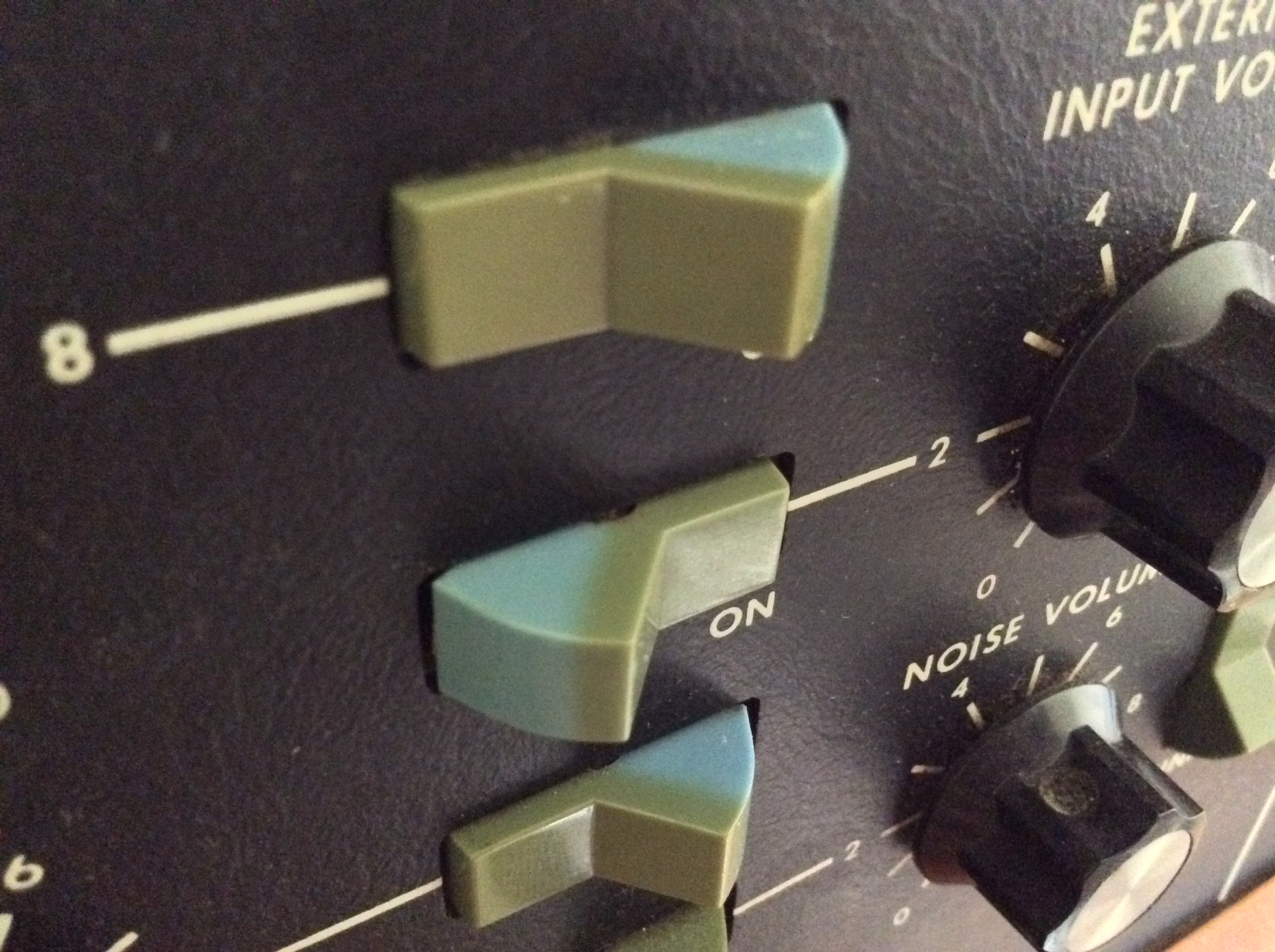

Is there some kind of miracle cleaner that can bring back the original color to these switches? Much as I find the two tone look amusing, I’d still prefer the original color!

I'm afraid you're stuck with the discoloration.

hi normhart, i have done some work on restoring uv-affected switch colors. i wrote a post on my blog about it, take a look at the last few pics where i brought back the blue switch tops from a greenish color back to the original blue...might help you.

Thanks Blackout. Those are very impressive results and are exactly what I was looking for -great work! I saw a video somewhere that restored old plastic computer cases that had similar uv related marring. This is what made me believe that it was possible to restore discoloration.

regarding the decoloration, I understand it will take much more time to happen when not exposed to direct sunlight?

You really need the UV light of the sun. The whole process and chemical reaction requires it.
A few guys have tried putting them under their lizard tank UV light and it *kinda* works.. but not as well and requires twice as long. It’s not as full spectrum.

Yes, this was done on the video I saw of an Amiga 500 computer case and keyboard restored to perfect original condition.
