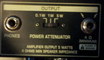

How do I connect the Mixer Out/Filter In cable of my Voyager safely to my Bugera guitar amp? I want to add some distortion.
I have the ring hooked into the input and I'm not sure whether I should plug the tip into the phones jack or the 4 ohm speaker jack.
Also, there's a power attenuator switch, that I don't know how to set. It has settings of 0.1W, 1W, 5W.

Other may correct me but I think you SHOULD NOT use the speaker output. The phones output may be ho too. The power selector is related with the speaker, BTW.
In your shoes, I’d use a stompbox or FX unit rather than an amp.

probably NOT wise to hook the speaker out into the voyager
headphone might work, but I would email Moog and ask if it's ok before trying it
why don't you just hook up the one of the L/R audio output from the moog, into the gtr amp and use it as a regular amp?

ummagumma wrote:probably NOT wise to hook the speaker out into the voyager
Well, I like to record stuff, and I don't really want to mic the amp and all that. Plus, I want to keep the stereo separation and all that. I just thought a little color would be cool.
