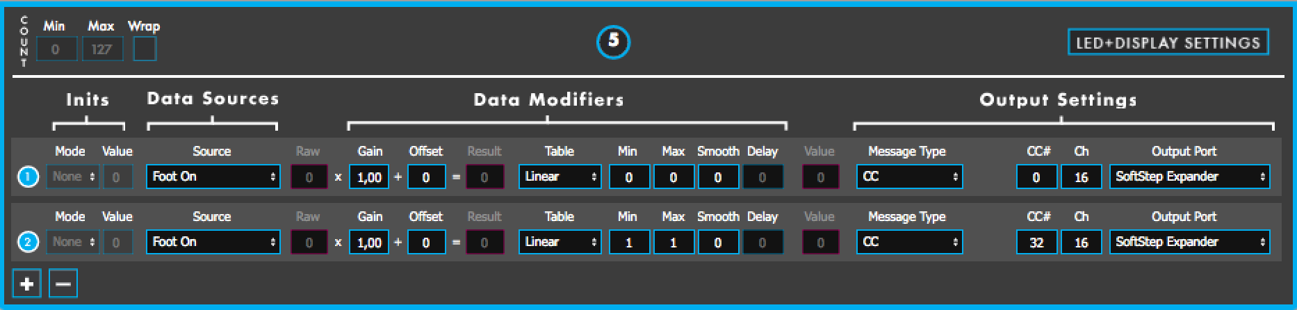

Hello there, I'm new here. I am trying to send a preset change from my softstep to my sub 37. I am sending CC # 0 value 0 and a CC #32 value 1 to the sub. It doesn't do anything. I am on the right channel. I'm sure I need to do something else as well. Can someone point me in the right direction? I've attached a screenshot below. Thanks.
Re: Sub 37 Program change with Arturia Beatstep Pro
found it already. Had to send a program change as well of course. My bad.
