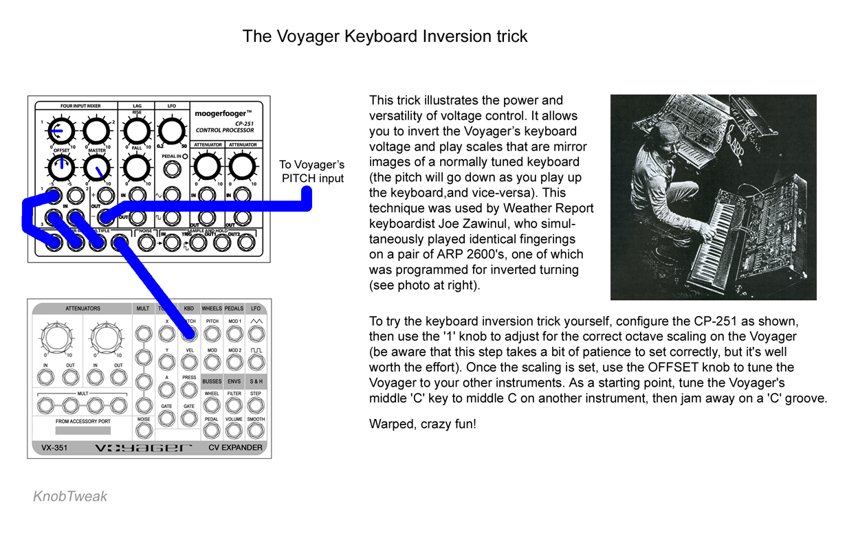

DeckardTrinity wrote:There is an entire world of sounds waiting to be discovered when you start plugging and patching the CV inputs and outputs.
Quite right! And things get a lot more interesting if you include the VX-351 CV Expander and CP-251 Processor in the mix. For example, here's how to create Joe Zawinul's 'inverted keyboard' (originally patched on an ARP 2600) on the Voyager :
