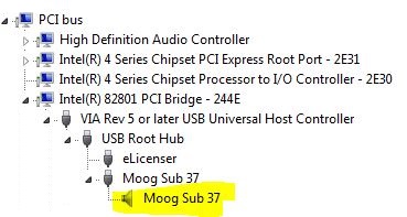

Firstly - Windows Device Manager has to "see" the Sub37 first, before the Editor or Cubase will detect it.
Device Manager > View > Devices by connection...
Device Manager sees Sub 37.JPG (34.96 KiB) Viewed 3156 times

jmatos
Posts: 6
Joined: Thu Sep 22, 2016 12:06 am
Re: Inconsistent USB Connection
Post by jmatos » Fri Dec 02, 2016 11:16 am
