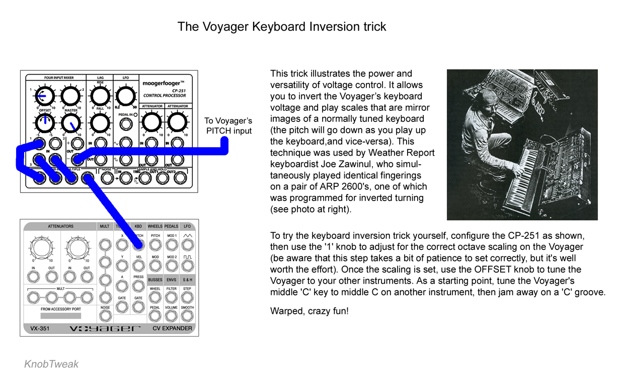

It might be possible, yes. I haven't tried this with the Sub 37 yet, but it can be done on the Voyager:
Zawinul style!
Zawinul style!
