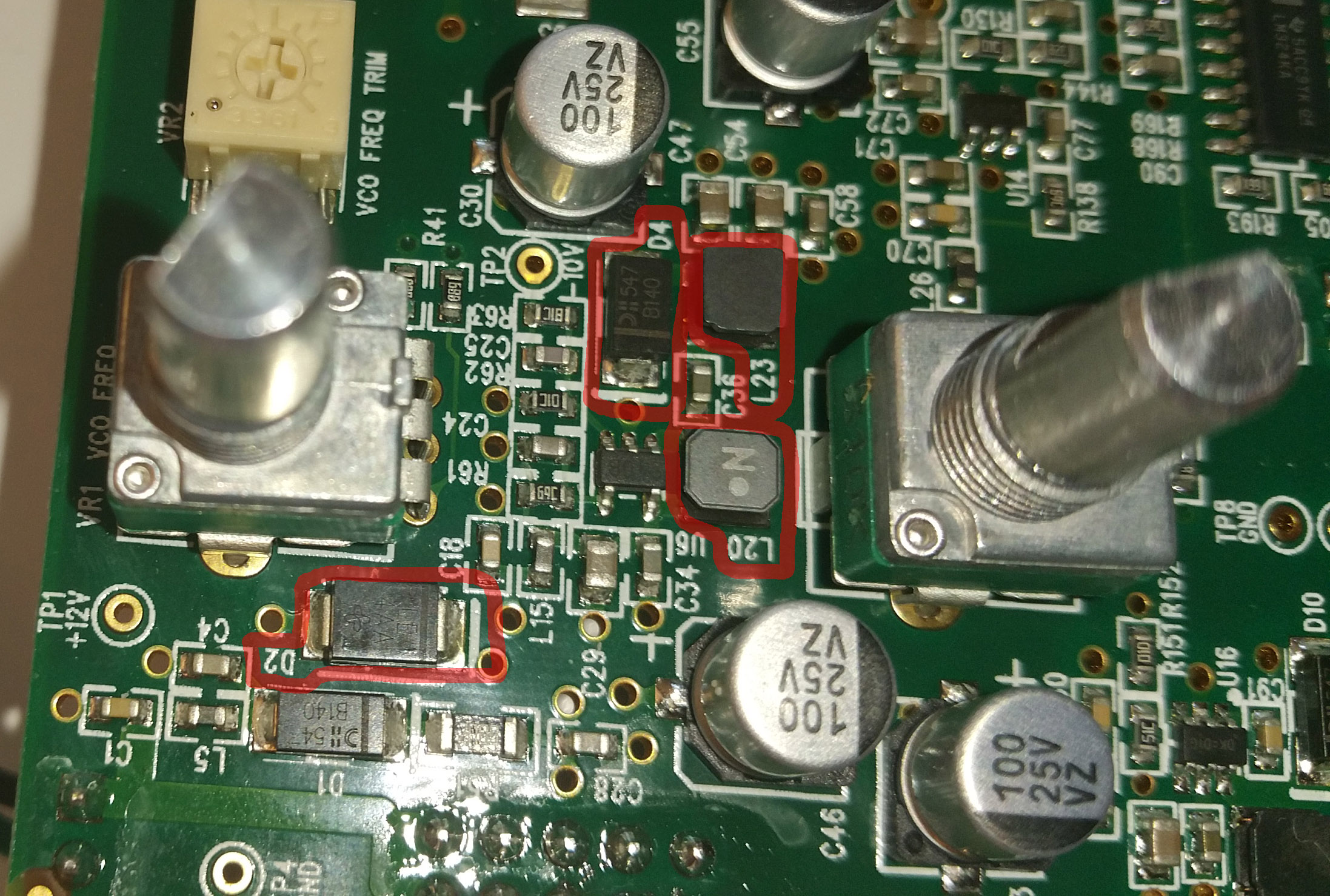

I've measured some of the parts following the power input traces. Looks like the board is two sided with a ground pane inbetween.
I've checked the diodes, resistors and capacitors in that area and I'm suspecting one of the following two diodes and coils:
D2, Marking "LE 4AA" - TVS Diode? Maybe a SMBJ12A? Can someone confirm this?
My readings are unclear on this one
D4, Marking "DI 547 B140" - Diodes Incoporated Schottky Barrier Rectifier B140 40V
Can measure electricity flow in both directions. Without schematic I don't know if the diode's bust or the reverse flow is from the layout.
Also I'm not sure about the two coils visible there (L20 and L23). Can anyone tell me the proper values for these?

Re: Mother-32 dead after brief 2 pin polarity inversion
I am sympathetic, honestly. I've done things like that many times over the years but have mostly gotten away with it.moebius wrote:I've measured some of the parts following the power input traces. Looks like the board is two sided with a ground pane inbetween.
You sound like you have plenty of technical knowledge so I don't really have much more to add.
Without schematics it's hard to say what might have broken, or why, or what needs to be replaced. Seems incredible to me that Moog didn't incorporate reverse voltage protection, especially as they provide a non-keyed header for Eurorack power (which poster above correctly says is easy to reverse) --- actually that wouldn't make any difference as the Mother only uses the +12v and 0v - all other pins are NC.
I can only suggest you ask Moog tech support.
I'd be interested to know what they say and whether you find a solution.
Best of luck.
Steve
And she is alive again! Woohoo!
Turned out I had to replace R51, which had changed its resistance. It's a small SMD resistor, so this might not be for everyone.
Kudos to the Moog suppport team, got a really nice mail with some ideas and that nailed it!
What is the resistance of R51 supposed to be? The Mother seems to be based on the Werkstatt, and it has a 4.99R resistor inline with the 12V input that has burned out on people (like me) who have used incorrect power supplies.
The smd resistor has a 2R00 marking, it has a resistance of 2 Ohm.grenert wrote:What is the resistance of R51 supposed to be? The Mother seems to be based on the Werkstatt, and it has a 4.99R resistor inline with the 12V input that has burned out on people (like me) who have used incorrect power supplies.
Sounds like a current limiting resistor if it's in series with the +12v supply. I guess it's possible for it to burn out if the current draw in reverse polarity exceeds its power rating. Not a great design I'd have thought. Diodes are plenty cheap!
