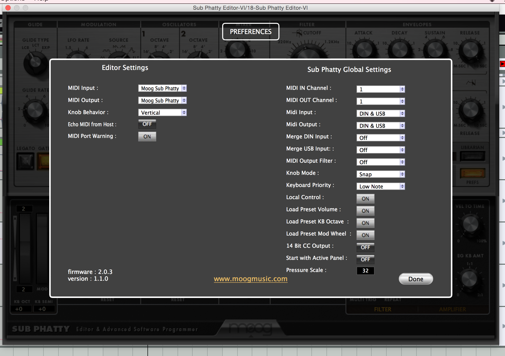

External Instrument prefs
Screenshot 2016-04-22 17.26.00.png (17.54 KiB) Viewed 2471 times
Prefs
Prefs

Works fine here. These are my settings:
MIDI Settings.
Also, turn on OUTPUT / SYNC if you want to send clock timing for arps & seqs.
As you can see, there's no audio returned from the Sub 37. (output displayed, yet input is the same)
This is my track setting. I can record MIDI from the Sub37 and play it back to the Sub37
Glad to answer any other Ableton Questions.

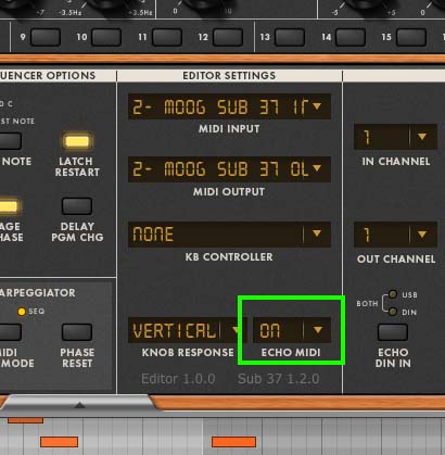

Hey! So I was able to get this working for me in Bitwig Studio by changing the "ECHO MIDI" setting of the VST to "ON"
Now I dont need to do any additional routing to get midi data from clips to go to the Sub 37. All i do is add the VST to the channel and bingo the midi data from the track is sent to the sub37.

Post by lowbis » Wed Apr 27, 2016 5:27 pm
Brilliant! Solved the problem for me. Thanks.
