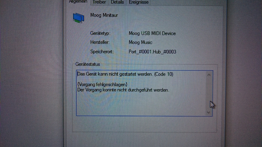

Hello, I received my Minitaur yesterday here in Hamburg/Germany. But I have to run it over DIN MIDI. USB MIDI doesn´t work. The reason seems to be a driver problem. I can see the moog on the list of my devices, but there is an error message. I tried a powered USB hub, the firmware update, installed all the actual content, changed cables and decided at last to run it over DIN MIDI, which could not be the final solution. It worked one time for 10 minutes in ableton via USB MIDI. I have noticed all the tipps here for usage with win. But now it´s impossible to run it over USB MIDI. The Minitaur is listed in my device manger , when connecting via USB, but alway show me error code 10 (Device can´t start), like in the picture I´ve added
Is there a chance to fix this?

Have you installed the moog midi driver, as this dose not work, you need to use the windows driver. So if you have uninstall that driver.klangweber wrote:Hello, I received my Minitaur yesterday here in Hamburg/Germany. But I have to run it over DIN MIDI. USB MIDI doesn´t work. The reason seems to be a driver problem. I can see the moog on the list of my devices, but there is an error message. I tried a powered USB hub, the firmware update, installed all the actual content, changed cables and decided at last to run it over DIN MIDI, which could not be the final solution. It worked one time for 10 minutes in ableton via USB MIDI. I have noticed all the tipps here for usage with win. But now it´s impossible to run it over USB MIDI. The Minitaur is listed in my device manger , when connecting via USB, but alway show me error code 10 (Device can´t start), like in the picture I´ve addedIs there a chance to fix this?
To get the moog minitaur to work with the editor in ableton you need to use a combination of a midi cable and the USB together,
you need to add the 'external insturments' to a midi track, setting this to use the midi cable.
then you need to add the AU editor and in the settings set the midi in and out to minitaur (USB)
will work perfect then.
let me know if you need any more help

THX it works at the moment
