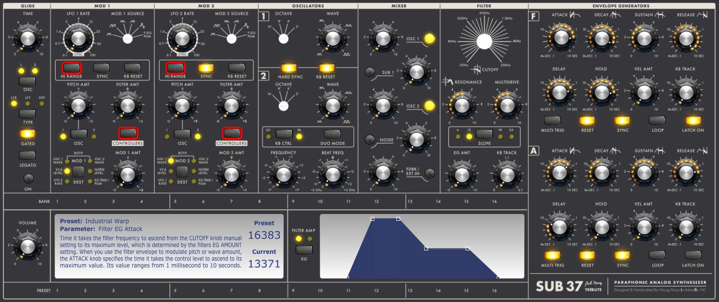

) maybe that you should look at Ctrlr that enables you to build any kind of panel for Midi devices.
It is based on Juce but uses the Lua language for coding when necessary.
I have manipulated JUCE a bit already and indeed it is a great piece of software, I did not know about Ctrlr however. I must say good job on your interface it looks pretty neat.
JUCE is king of fancy gui but a bit out of my confort zone, right now I keep with tech I'm familiar and avoid a learning curve. Focus is on the feature set I want to implement.
