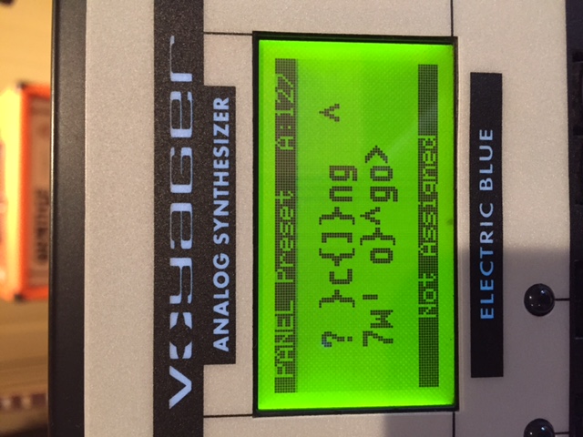

Evening, I have a problem where if I do not play my Voyager for a while, the presets get corrupted. See attachment for a screenshot.
Ordinarily, I will just reinstall the OS, and then reinstall all 4 banks, and I am back in business. The problem is this happens maybe once every year and a half (like I said, it has to sit a while). So, I am reinstalling the OS tonight, following the instructions in the download (install bank B/D, then A/C/D) , and also following alternate instructions from another site (A/C/D, then B/D). But the problem I am having is, it never asks for bank C. I install B/D, then A, and when A is finished it asks for D instead of C.
I cannot install sound banks successfully, they corrupt after maybe preset 15 (after which, as you can see in the attachment, they are garbled).

Hi @dzanzandt, couple of questions that you didn't address in your report. does the corruption only occur when the power is off, or will the banks be fine then suddenly go bad with the power off? Also, does the corruption to the OS and the presets happen at the same time, close together, or seemingly seperately?

Hi all,
there's no need to reload the OS when there's no message like "the operating system has to be reloaded".
Please NOTE: when the Voyager is off for half a year or so the rechargeable battery can be empty and this is the reason for garbage in the presets.
Switch on the Voyager for a few hours from time to time and the battery should be charged to hold the presets for half a year.
That's all!
Have fun,
Rudi
