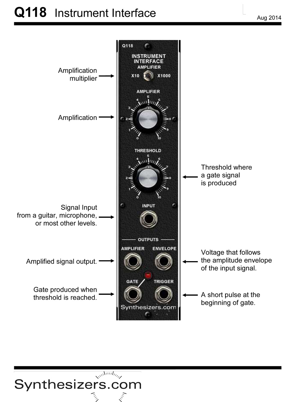

Well, there's this:

All you really need is an amplifier to get the gain to 5V, a rectifier to remove the negative excursions, and a Cap & Resistor low pass to smooth out the original signal into some kind of envelope that would satisfy the kbd gate condition. Basically an envelope follower without a gate output. Add a one-shot and there's your gate!
But if it was me, and it will be sometime this year when I add a 5U rack :-), I'll just buy an envelop follower like GregAE posted.
