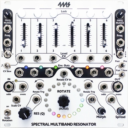

Well, Moog is sort of missing the boat here. Check out the 4ms SMRF:
http://vimeo.com/132412775
http://www.4mspedals.com/htnew/smr.php
Basically a 6-band MuRF where the filters can be tuned to musically interesting intervals, even used as resonators with no audio input. Or a patchable vocoder!
Say what you want about small scale modular, but it seems the sonic palette is ever-expanding. An interesting perspective from MI designer Olivier Gillet:
