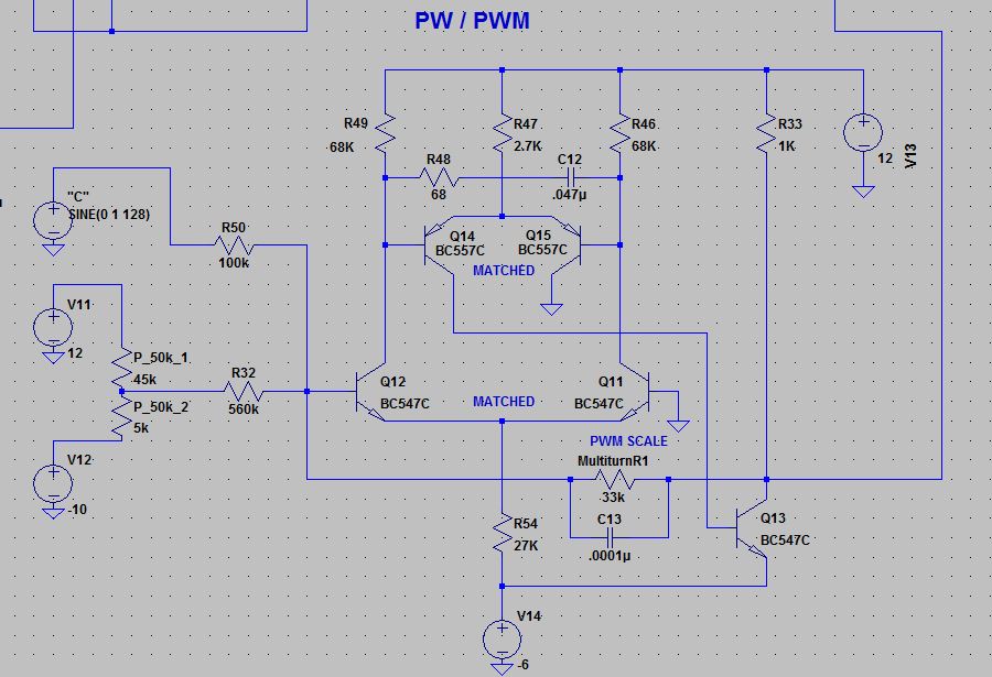

Wouldn't it be better to control the PW for each oscillator separately? Controlling the PWM from an oscillator controller (901A, 921A) means all dependant / controlled oscillators create the same square pulse width, but I would say PWM is a feature of an oscillator itself, the unit which creates the square wave. And one would be more flexible. One can thicken the phasing sound of an oscillator (bank) in a more subtile way or in a more aggressive way by modulation multiples. So here is my proposal for discussion:
I made a spice simulation of a 901 with PWM in the oscillator section. See a Moog modular standard CV mixer section below which I copied and used for buffered CV Input for PWM: (I am sure it could be simplified somehow, but I'm not sure about buffering is necessary or not...)

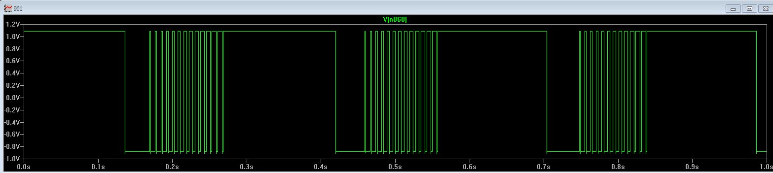

The CV is fed to the base of Q3 (see 901B circuit diagram) via an R2k2. The "C" input is omitted. The resulting square wave simulation is the following:
The prototype is currently under construction.

That is kinda what I have done analogmonster (sorry don't know your name). I have two oscillators per controller - and two controllers in the system. I added the PWM per bank (901a)... so if I want to I can indeed have two separate oscillators with different rates of LFO. But I can also have two sets of two oscillators with different LFO rates. It's the best of both worlds. And when I eventually build my own 901a and 901b set... I'll probably add the same function to those as well.
