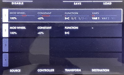

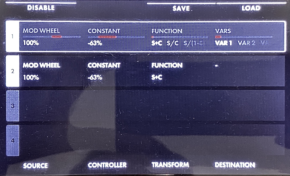

VAR as Destination in Mod Matrix presets
Repro:
1. save a Mod Matrix preset which includes VAR as Destination
2. append this preset to the current Mod Matrix
Result: the Destination which used VAR will be loaded as blank (unless you choose to replace the current Matrix)
