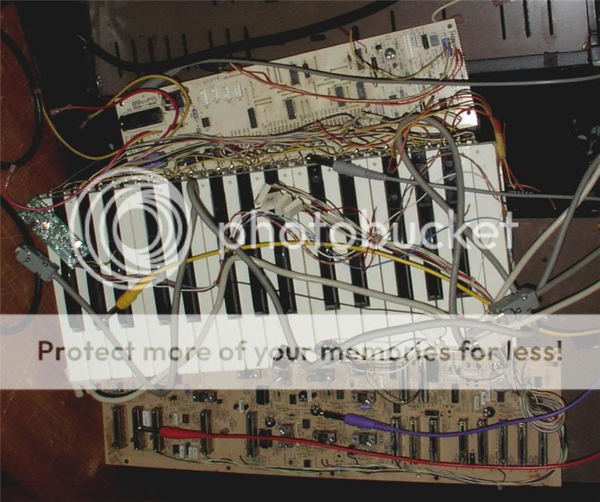

Portamental
Posts: 888
Re: Moog Source Problem - Any help appreciated!
Post by Portamental » Thu Mar 08, 2012 9:54 pm
Errrr.... got this old synth. It only makes noises when I step on it. What's wrong with it ? :mrgreen:
Post by thealien666 » Thu Mar 08, 2012 10:02 pm
I see your problem; there are old computer serial DB9 cables that don't belong to the synth... :twisted:
You should have put a warning for sensitive analog synth lovers out there, that might be shocked by a picture of such a deeply wounded subject... :lol:
I'm afraid my remote diagnosing talent is not up to this monumental task ! :shock:
EDIT:On the positive side, the foam has been removed... :roll:
