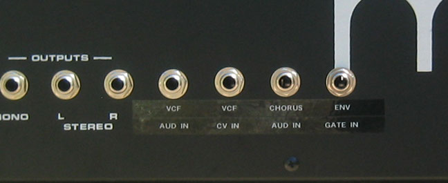

I did add some inputs on the back of mine for audio, filter CV and S-trigger. Makes for some interesting sounds patching a sample and hold on the filter and such. Can also route back the string section audio into the VCF section, and control it all from the panel via the left/right sliders. Fun stuff!

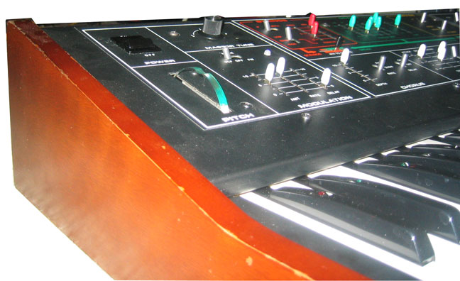

On the same one, I added a clear, lit mod wheel. Looked cool.
I think of the Opus as being almost completely the opposite of a Minimoog, but as such is very complimentary.

Portamental wrote:I was wondering about adding the usual pitch and gate CV. In your case, the S-trig triggers what ? VCA for audio in?
They would be the inputs to the filter section. Audio in to the ladder filter, trigger to fire the envelope generator and the CV to that same filter the envelope and LFO is controlling.
I generally have it patched with the left output looped back into the external audio input. And use the right output as the main. That way I can route the string section into the filter section simply by adjusting the output pan over to the left, or add a feedback loop from the filter section back into itself.
Here is a very small sample from a radio show where the Opus was played with a sample & hold CV signal from an Oberheim two voice mini sequencer. The Oberheim was playing a sequence that was synced to the Opus via the s&h output patched into that filter CV input on the Opus.
36 second sample of an Opus 3 with sample and hold on the filter section
A simple mod, but it really added to the versatility of the Opus 3. I tried to make the mod look like it was stock.
