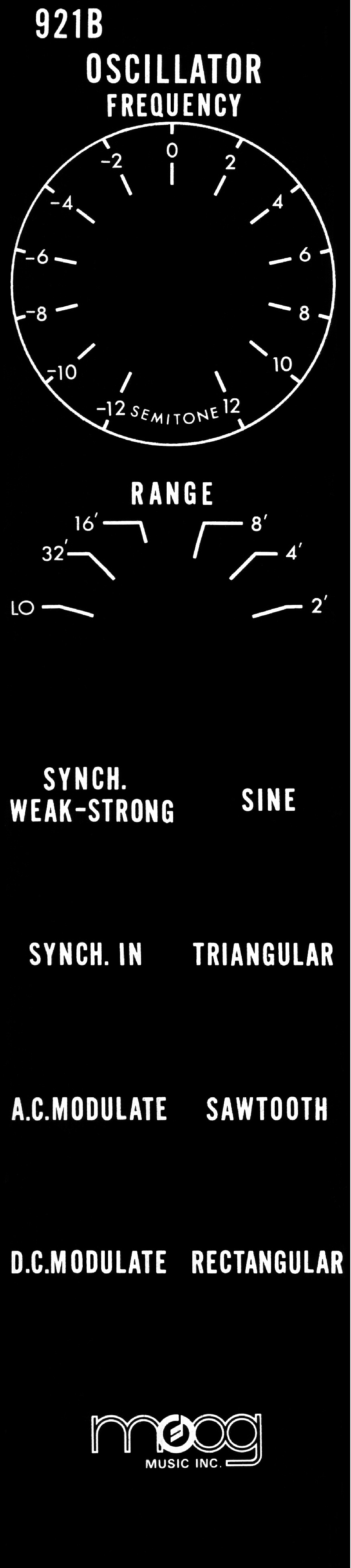

In the meantime, I'm designing the panels layout for the 921A and 921B modules and, as soon as they will be ready, I will design the PCBs, some photos of which I found on this forum, thanks to the guys who shared them.

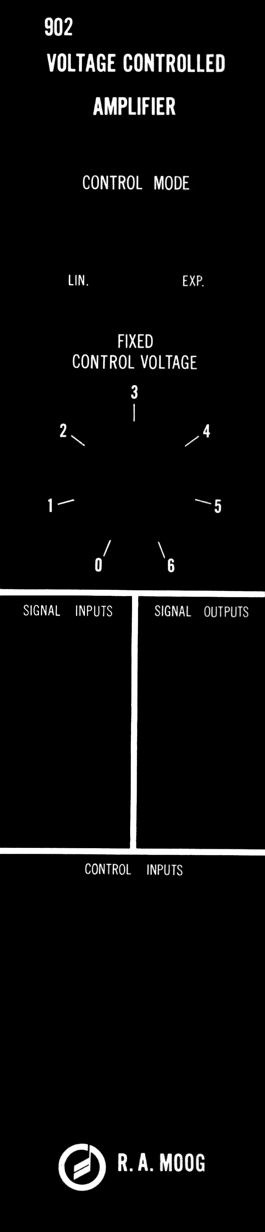

I don't know if these will help, but here's a couple 450dpi scans of two unpopulated Moog panels, a 921B VCO and 902 VCA.
Jack placement is up to you unfortunately. (they didn't scan)
http://www.synthfool.com/moog921b.jpg
http://www.synthfool.com/moog902.jpg
