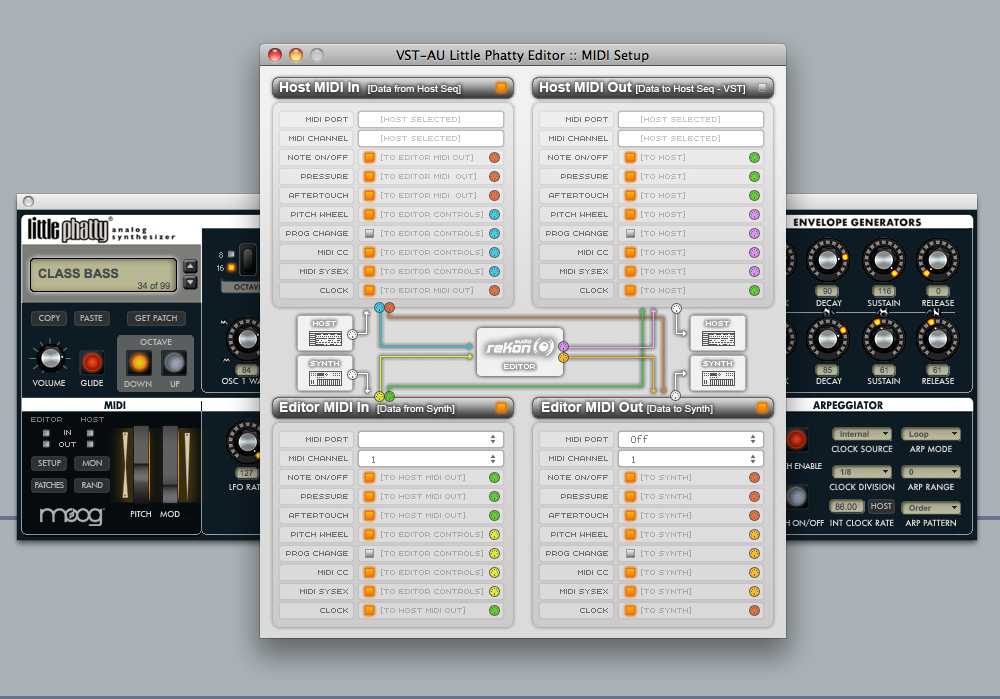

Here is my non-working Midi Set Up

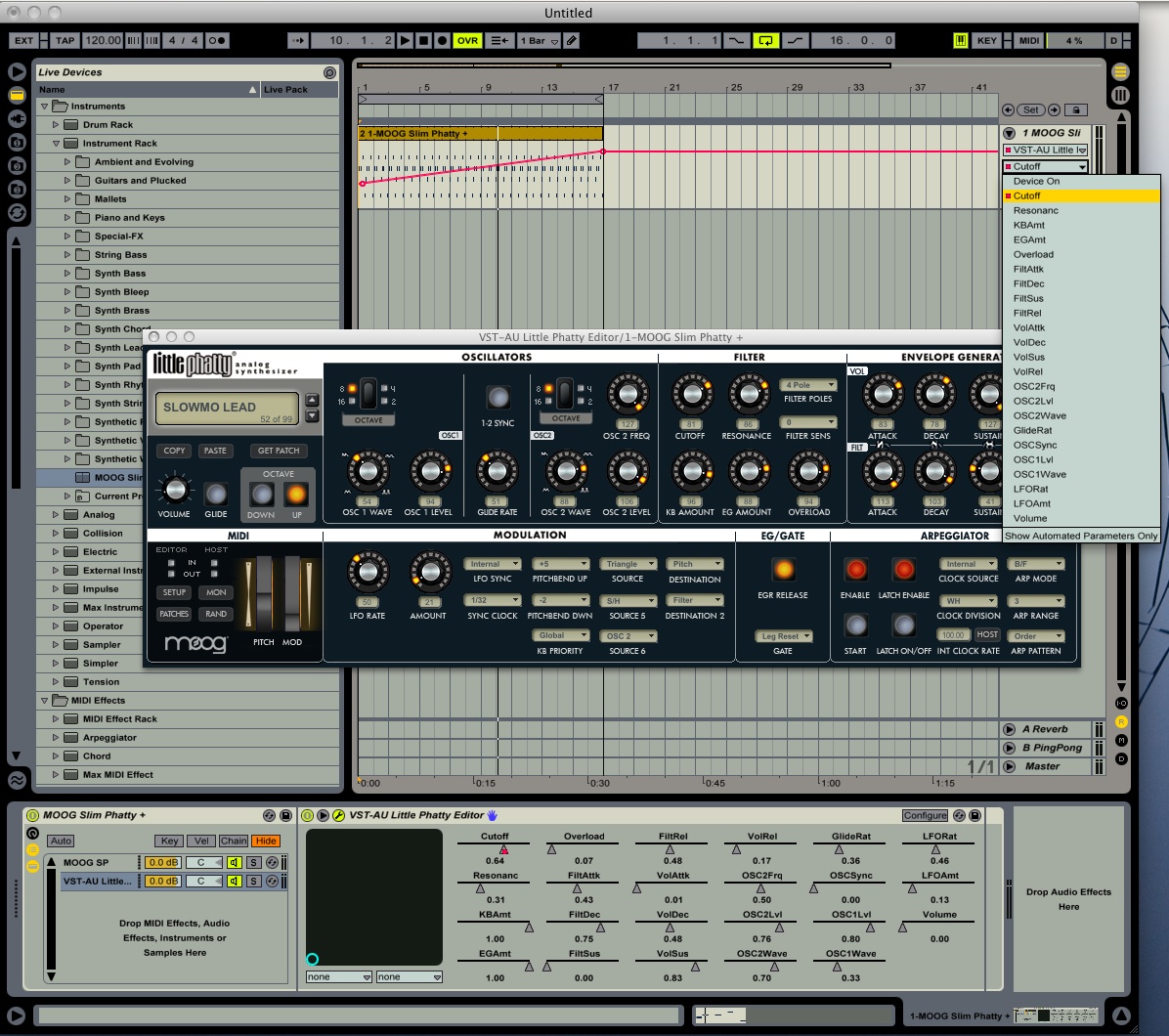

Firstly, Amos just emailed the new OSX VST, and although i can't hook it up to my LP cause im in my office, it looks much better - see attached image for setup config :) So drop him an email/PM and see if he can help you out.

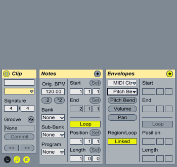

Also I've attached an image of where the pattern setting is in your clip setup. It's actually called 'Program' sorry my bad :P

Well gentlemen, I must say that Amos from Moog Music is a very committed individual... he has taken the time and sent me the updated (unreleased) MAC version of the VST/AU Little/Slim Phatty Editor which it isn't 100% functional as of yet but I thing we're almost there. So far I've gotten all the parameters on the VST/AU Editor to sync with my Slim Phatty and I have actually been able to automate all the parameters via VST/AU, however the only issue right now (BIG ONE though :( ) is that the automation on the VST/AU Editor parameters is not affecting the sound of the Slim Phatty which I'm assuming has to do with the AUDIO/MIDI set up somewhere along the line.. I'm pretty confident that with Amos' help we will be getting this to work 100% on the MAC platform.
TIP :!: : The best way to set up the VST/AU Little/Slim Phatty in Ableton Live is to create a MIDI channel, then create an INSTRUMENT RACK, then throw in both the EXTERNAL INSTRUMENT TOOL and the VST/AU Little/Slim Phatty EDITOR inside the INSTRUMENT RACK you just created... to get the parameters you need to show up on the on the VST/AU Plug-in signal chain (at the bottom of your screen), click on the "Configure" button and just click and wiggle on the VST/AU Plug-in window the parameters you want/need, these will then be configured and will show up as a fader on your VST/AU Plug-in signal chain (at the bottom of your screen) and be ready to be automated on your arrange view window.
If you have any questions so far, do not hesitate to ask.. I'll be glad to help, please see attached screenshot of my progress so far...
I'll keep you all updated on the progress...
PS. NEITHER the automation data nor the movements on the VST/AU Parameters are affecting the sound of my Slim Phatty wich is the ONLY issue left to resolve, :?: if anyone has any idea as to how to get this issue corrected based upon the set up of the screen shot below... we are good to go!!!

jpromano78 wrote: the automation on the VST/AU Editor parameters is not affecting the sound of the Slim Phatty which I'm assuming has to do with the AUDIO/MIDI set up somewhere along the line..
Ahoy there -
in your screenshot (http://www.moogmusic.com/forum/download ... &mode=view):
"Editor MIDI Out" (data to synth) is set to "OFF." That means no control output from the editor to your Slim.
So, double-check this setting... "Editor MIDI Out" needs to be a MIDI output that is connected to your Slim.
See if that gets you to the finish line, or if it raises additional questions... :)

Amos wrote:"Editor MIDI Out" (data to synth) is set to "OFF." That means no control output from the editor to your Slim.
Thanks Amos, makes sense however I can't seem to know where this "Editor MIDI Out" parameter you speak of is located, if you could point that out to me would be most helpful. A "zoomed in" screen shoot from my own initial screenshoot would be wonderful... as they say: "a picture is worth a thousand words"
Awaiting your comments.
Thanks again.

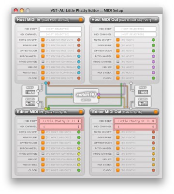

acatcalledanarchy
Posts: 88
Joined: Mon May 04, 2009 5:12 pm
Location: Guernsey, Channel Islands
Re: Slim Phatty VST Editor MIDI Set Up
Post by acatcalledanarchy » Wed Feb 23, 2011 5:56 pm
Hi Jpromano78...
Refer to the below screenshot.
Happy tweaking!
Laters
Peace, love and flowers...
A Cat Called Anarchy
Voyager Select Series Whitewash Electric Blue, Little Phatty Stage II, Minitaur
Amos
Posts: 2438
Joined: Wed Jul 23, 2003 3:11 pm
Post by Amos » Wed Feb 23, 2011 6:03 pm
Ha, I had just finished a much uglier version of the above in MS Paint.
well done, that man :)
jpromano78
Posts: 23
Joined: Thu Jan 27, 2011 11:15 am
Post by jpromano78 » Wed Feb 23, 2011 10:54 pm
acatcalledanarchy THANKS!!!!!!! :wink: It worked like a charm!!! I got everything working perfectly now... Well almost there.... I'd say 95% there!!! The only thing I need now Mr. Amos when you get a chance please send me the .fxb file for the Slim Phatty Factory Presets so that I can load the on the AU and we're done!!!! :mrgreen:
