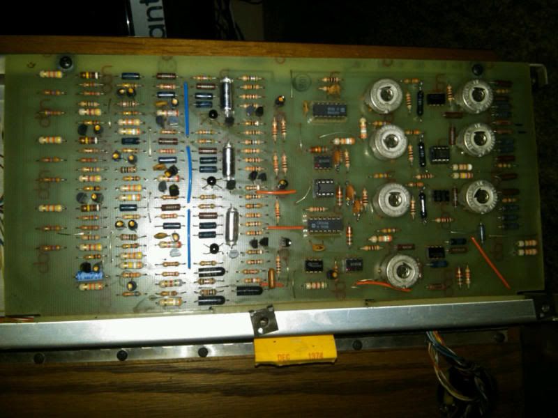

shipatsea wrote:
do you know how I would tell by looking at the board if they are matched? Any special markings?
Seems they marked the matched pairs with colored paint dabs. The newer schematics I have indicate only the bottom pair were matched, indicated by the circled "M".
This would seem correct as the bottom pair on my 108XX Mini has the bottom transistors with violet markings and the top four pairs marked in blue. I would guess the blue marked ones were a least screened and selected.
From the photos you posted, it looks like the same markings, the bottom two with violet paint dabs and the top ones with blue markings.
Cropped and brightened photo:
I could see where if the transistors in the ladder were really mis-matched, it would throw the filter poles off. But it would seem Moog used selected but not perfectly matches transistors in the top pairs. Still it would be interesting to swap in matched sets to see if there is an audiable difference. I have my doubts though that it will sound like an RA Mini with the old oscillator board, but could be an improvement? I have a bag of new TIS97's from Mouser.
