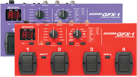

I have been using ZOOM GFX-1 with my T1.
All parametters in ZOOM are off except output levels.
As you can see the attached, ZOOM has four switches so that we can select four effect types.
My ZOOM is just only for volume selection switch for T1.
Now, I am expecting if T3 can store four types of volume without changing the sound.
