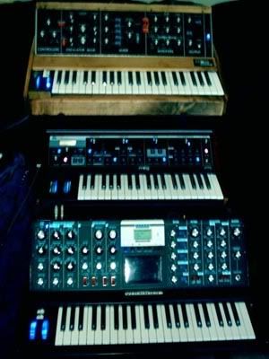

Well, I think if I sold my mini (that was modded by Mr. Lightner) I'd have no problem getting more than a regular old mini off ebay... What do you guys think?Kevin Lightner wrote:
Do mods lower the value of a synth?
Usually, yes.
But there are well-done mods and hack jobs.
Nice ones might make such a synth more valuable in the eyes of someone who appreciated the mod(s).
Maybe yall disagree... But, look at that thing.. Its a beaut !!!
I believe thats the only mod he did, except maybe glide time increase, (right Kev?)...
Some mods I think are a bit crazy, the ones that invlove mounting jacks and/or switches to the panel or body. A popular one is adding Osc 2->Sync.. I think the Prodigy or Phatty sounds best for that though.. On the other hand, I haven't heard a Kevin Lightner version of that mod, so I could be wrong
