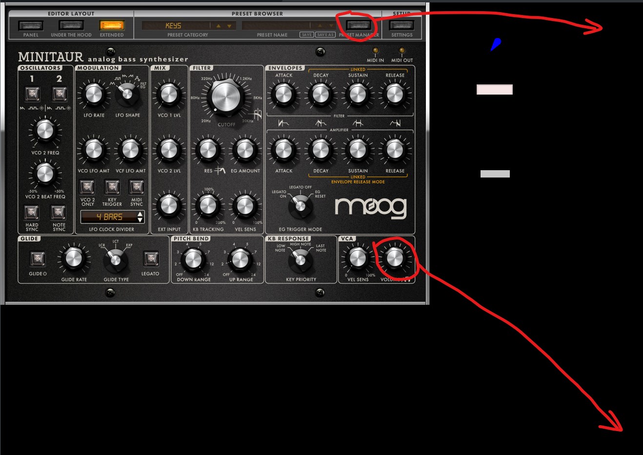

when opening the Minitaur Editor (latest) as a VST instrument in my DAWs, both Bitwig (latest) and Presonus Studio One (latest), the GUI is shown too little/shrunk. And the reading of the mouse position is accordingly not working correctly. To turn the button on the bottom right with the mouse I have to move the mouse to the corner in the bottom right of the black window.
So if the resolution of the GUI would be scaled bigger to fit the black parts of the instrument window, the mouse position would fit the mouse reading again. Hope that makes it clear?

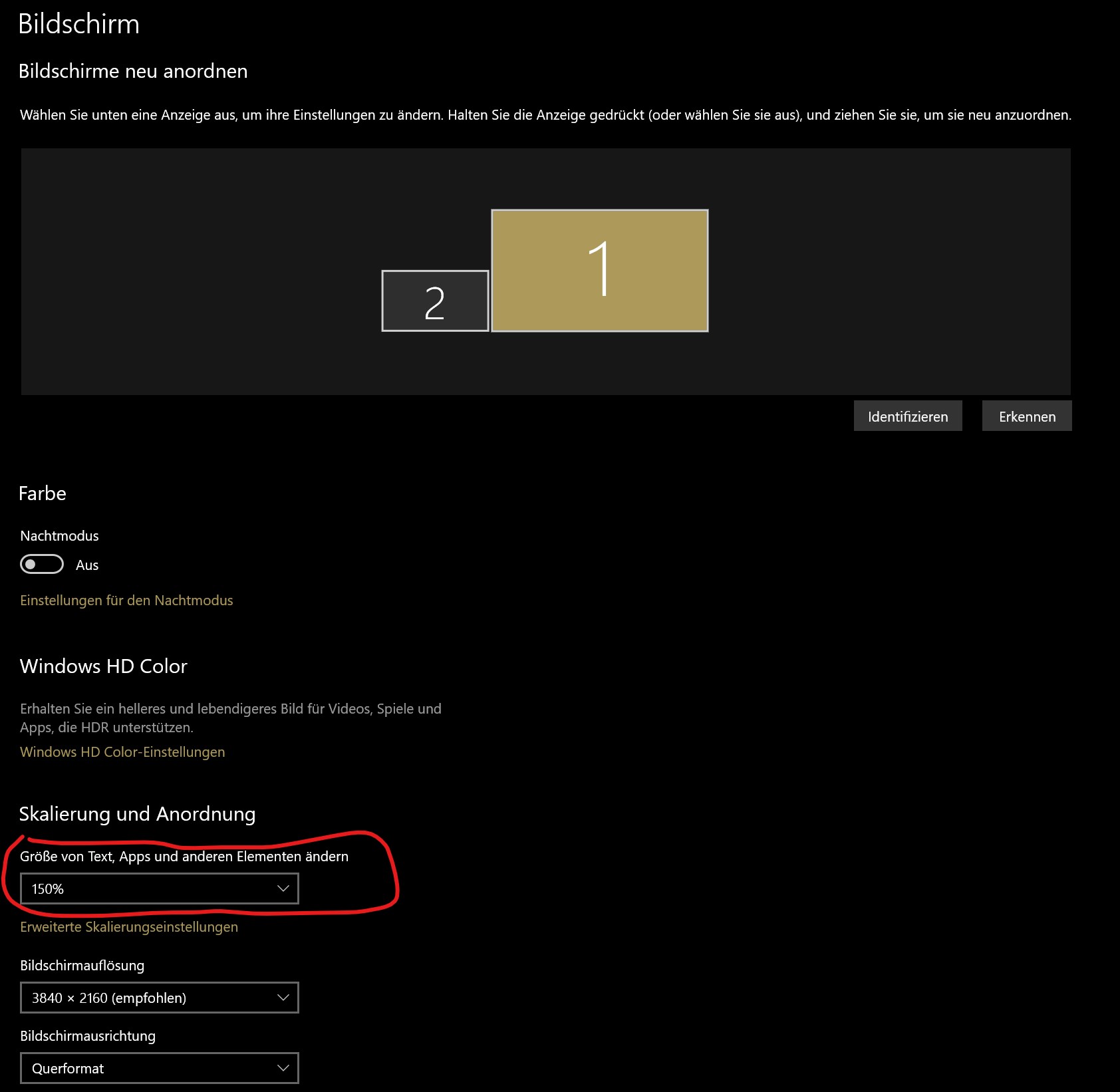

My Windows scaling is put to 150%. Maybe that is a reason? But I do not wanna change the whole Windows scaling only because of this editor.
I cannot really see what I click/drag. I cannot use the editor like this. :|

I found a workaround for this.. you need a second display with native resolution at 100% scaling.. you transfer your DAW there, open the plugin and then plugin opens in good scaling/resolution... then you just move your DAW back to your main display and leave plugin windows on the secondary display and use it from there.. :)
