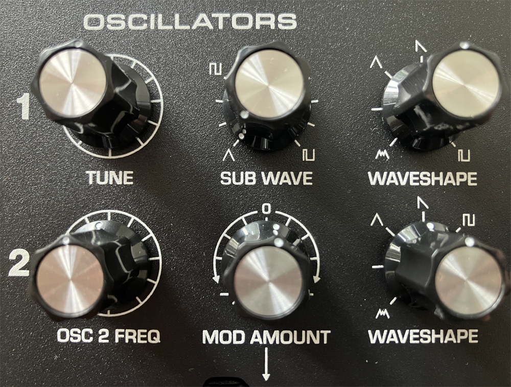

I'm loving the sound & features of my new Messenger, but the knobs don't seem to be calibrated correctly:
- With bipolar control knobs, the neutral position isn't at the center/noon position. This is most noticeable with everything to do with oscillator pitch.
For example, the neutral (A = 440) position of the tune knob is about 1 degree clockwise from the noon position.
The neutral position of the osc2 pitch knob is about 2-3 degrees counterclockwise.
The neutral position of the osc mod amount knob is about 3-4 degrees clockwise!
- On all knobs, settings about 4-5 degrees fully cw or ccw don't seem to do anything!
[edit: meanwhile, somone on the sequencer.de forums has pointed out that this last bit probably isn't a fault, but a characteristic of the pots. but obviously, the main neutral/noon position calibration issue remains]
So clearly, those knobs haven't been calibrated correctly at factory.
I've tried a factory reset and the tuning procudure (available in fw v1.07), neither of which changed anything.
So, how can i recalibrate all those knobs?
Is there a panel calibration mode? If so, how do i enter it?
A google search finds panel calibration procedures for the Sub37 and the Muse, but not for Messenger....
Messenger knob/panel calibration?

just to illustrate, here is what the neutral/center position of the osc2 mod amount pot looks like on my messenger. according to moog, that's just fine.
