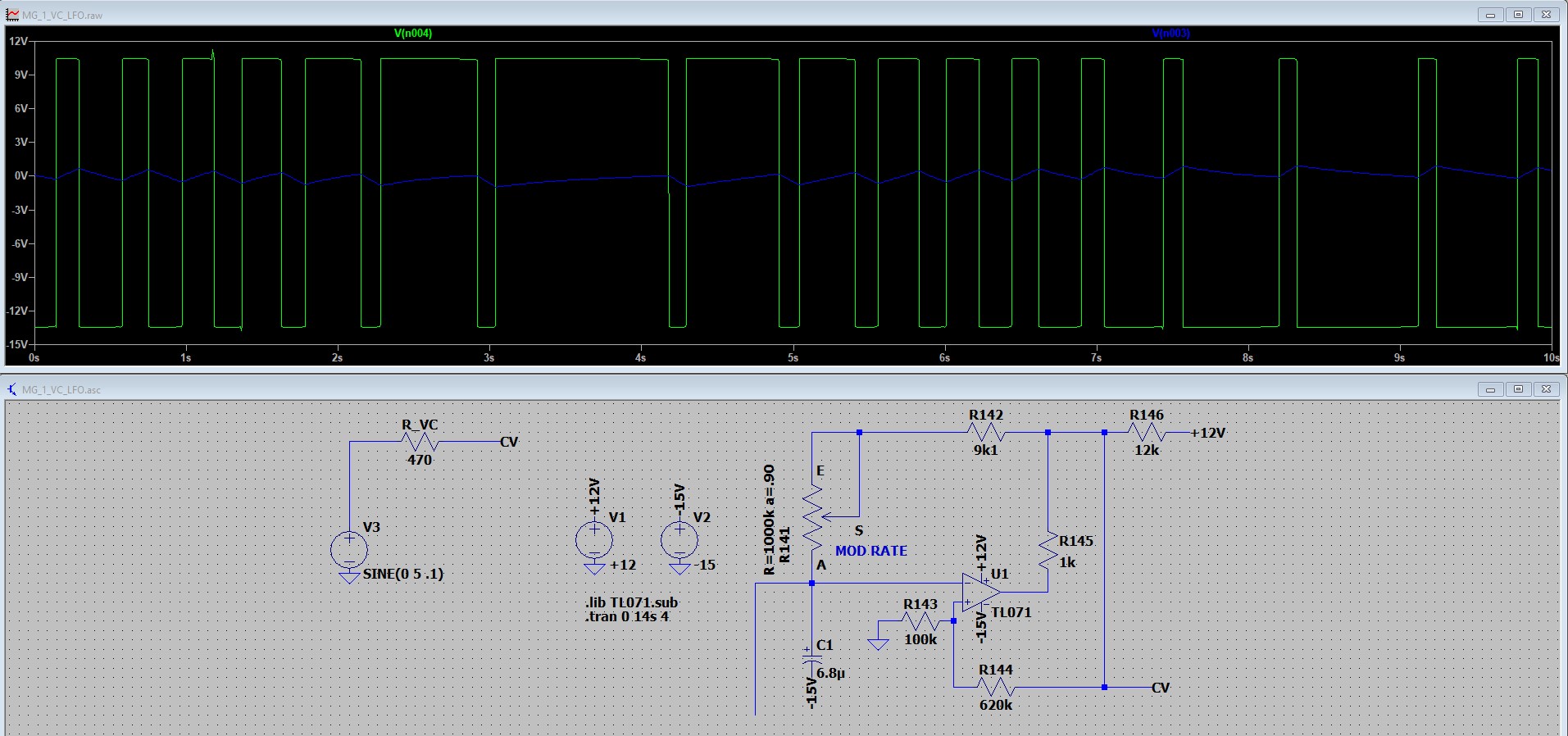

charliekuldip wrote: Thu Apr 11, 2024 10:05 am One thing I have on my 'mod wishlist' is adding an external input for VC to control the LFO. I see some mentions of that on the forum but no real specific instructions.
I agree. CV controlled LFOs are magic. And if two VC-LFOs control each other, it is even cooler LOL. I emulated ratcheting with an VC-LFO controlled by an EG. Listen to my track You from time point 5:13, there you can hear it.
charliekuldip wrote: Thu Apr 11, 2024 10:05 am Does anyone have any schematics for adding a VC input for the LFO?
It depends on the LFO circuit of course, _where_ you have to feed the CV in and _how_ you feed it in. I did this for my Formant LFOs, see also here: VC-LFO
For the MG-1 LFO you must feed in the voltage at the connection between R142 (9.1K) and the MOD RATE slider R141 via a 1K resistor, I assume, but I will check it with LTSpice and communicate the result here.
analogmonster
Posts: 357
Joined: Wed Nov 24, 2010 9:50 am
Location: Germany
Re: Moog/Realistic MG-1 Mod Guide
Post by analogmonster » Thu Apr 11, 2024 12:49 pm

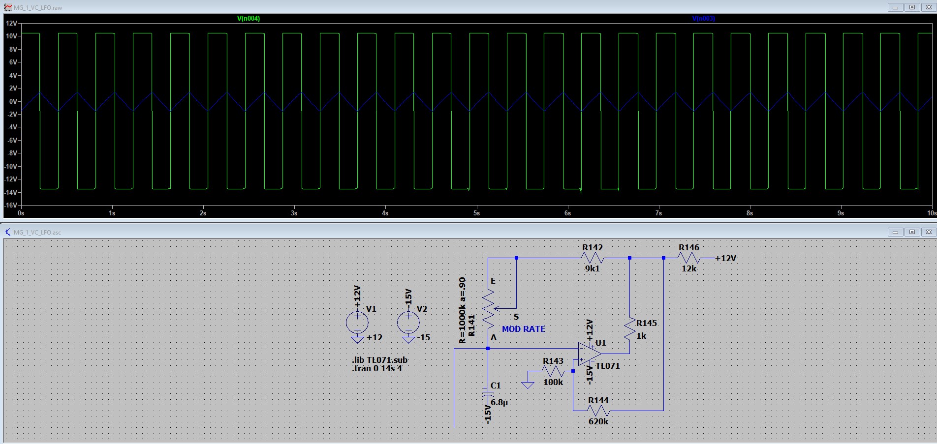

analogmonster wrote: Thu Apr 11, 2024 11:10 am ...
I was wrong. The MG-1 - LFO is current driven, not voltage driven like other LFOs (like my Formant LFOs I modded with voltage control). But you can add a CV between R144 and R146 via 470R resistor in your MG-1. See the LTSpice results of the original MG-1 LFO and a VC variant at MG1_LFO and MG_VC_LFO. The triangle and pulse LFO outputs change in frequency when an e. g. 5V sine is added to the point I mentioned above, but as side effect the LFO amplitude decreases a bit. To compensate that a more complex circuit would be needed or better a voltage driven LFO, no current driven LFO.
