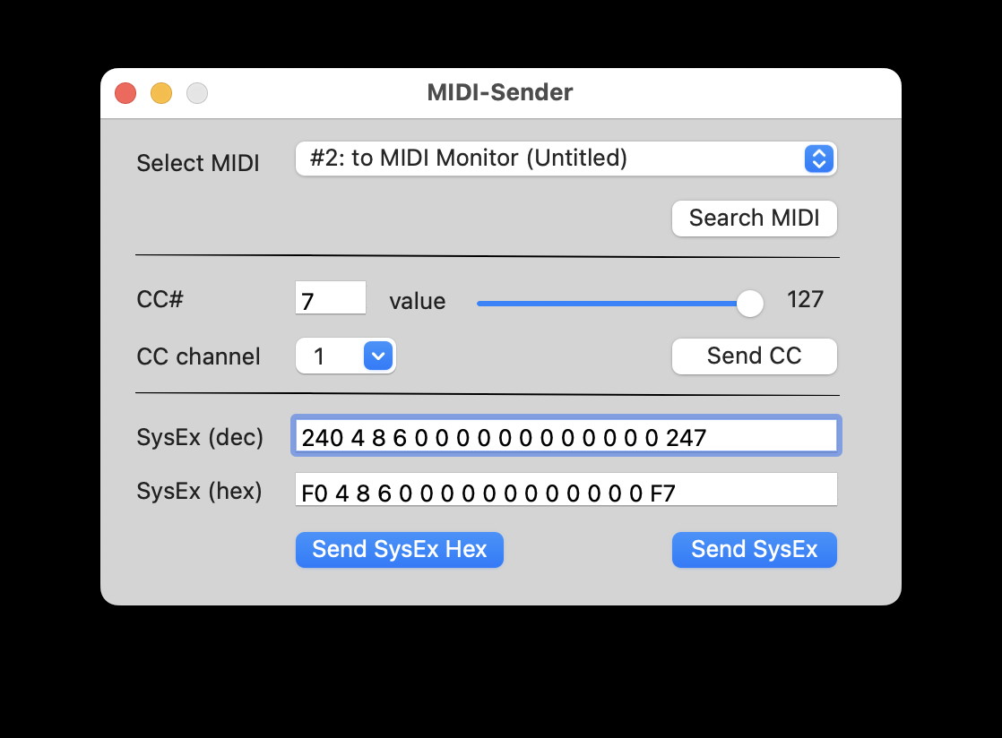

Any suggestions on best method to send and record sysex at the same time? I'm trying to send via Max and record with Sysex librarian, but I don't seem to be getting the message format correct in Max. Trying to use sxformat object. Maybe there is a more simple method?

I built myself a very simple self made App to send out small SysEx strings. And I use SysEx Librarian on my macOS to record the received Minitaur SysEx patches.
Download and use at your own risk: https://till-kopper.de/soft/index.html#midi-sender
And as I am not a certified macOS developer (cost me too much), you will get a macOS message about telling you about this.

Thanks Till
Re: Copy all settings from one Minitaur to another?
Hey that's cool! Thanks Till!
