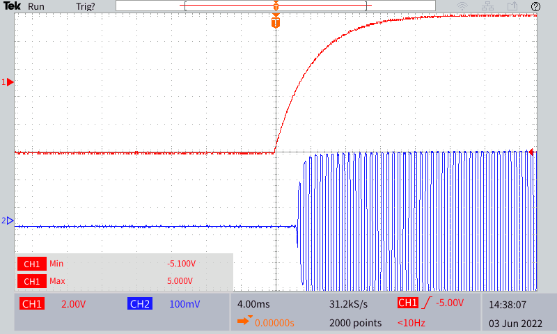

With the new CV functionality, I've tested how M1's modulation signal looks like.
What you see below is oscilloscope screenshots of LFO1 set to a square wave. Notice that there is a substantial amount of smoothing applied and the square wave doesn't exactly look like you would expect. For comparison, the first screenshot includes a square wave coming from an analog LFO on a modular synthesizer.
red: Moog One LFO1 square wave at 5Hz
blue: square wave LFO on a modular synthesizer

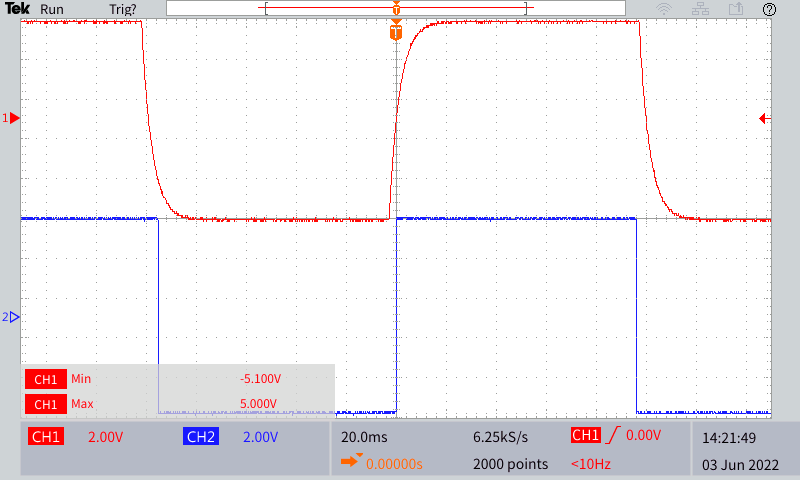

It looks like this heavy filtering has only been applied to the CV output and not to the modulation signal in the Mod Matrix.
red: CV output: This is a close-up of Moog One LFO1 square wave at 5Hz,
blue: audio output: the same LFO modulates OSC1 Mixer, notice a 3ms delay, but also a much sharper square wave.

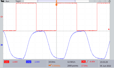

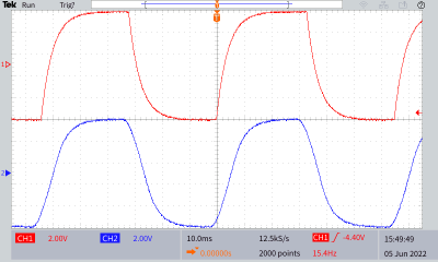

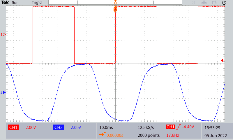

In case you think about using M1 to process external CV, unfortunately the incoming signal will be filtered as well.
red: a square wave from an external analog LFO @16Hz
blue: the same square wave going through M1. (CV IN > Matrix > CV OUT)

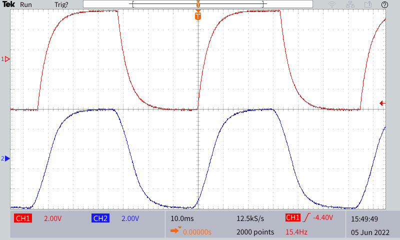

red: M1 LFO1 square wave from CV OUT1
blue: the same square wave looped back through M1. (CV OUT2 > CV IN > Matrix > CV OUT3)
