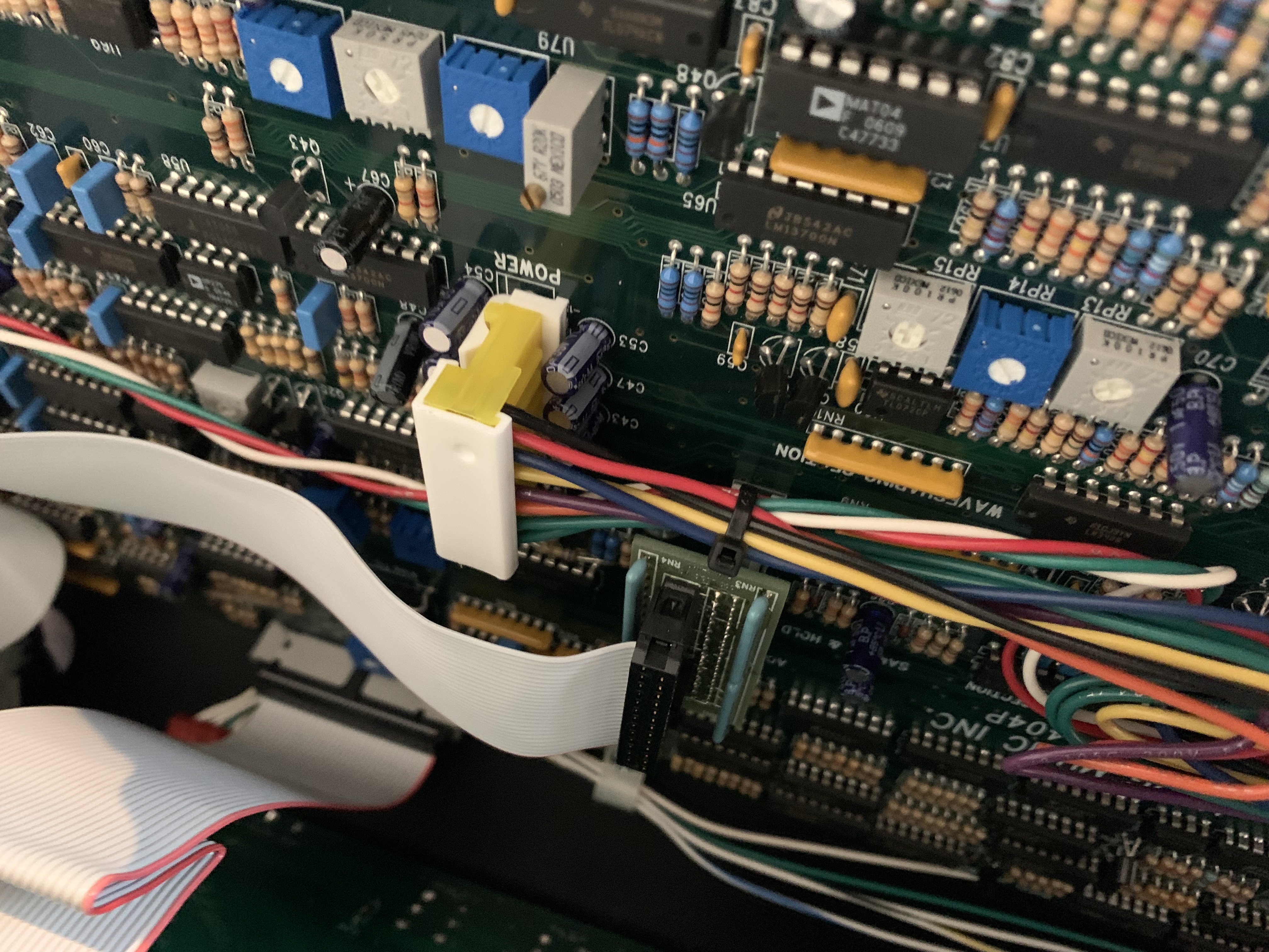

So I bought my Voyager perfomer with vx-351 and cp-251 many years ago, but only up until recently I am exploring 5u modular with the voyager as a centre piece.
When I connect the KBD pitch out to any of my 5u modules, tracki g is perfect but off (Ab instead of C).
When I bought my Voyager and VX there was mo output adapter board (460) supplied and I assumed it was pre-installed, since the cv-outs seem to work.Could not having the adapter installed be causing this pitch offset?

The adapter board is there, so that can’t be it ;)
