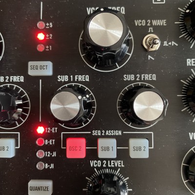

Also, on the Subharmonicon, one of the 'white dots' is missing from the top of the knob - which makes a harder to set values while composing/performing.
Is this considered within normal QC tolerance for Moog products, or would this be considered something that is not accepted by QC.
(See attached picture - VCO 2 Sub 2 freq knob)
