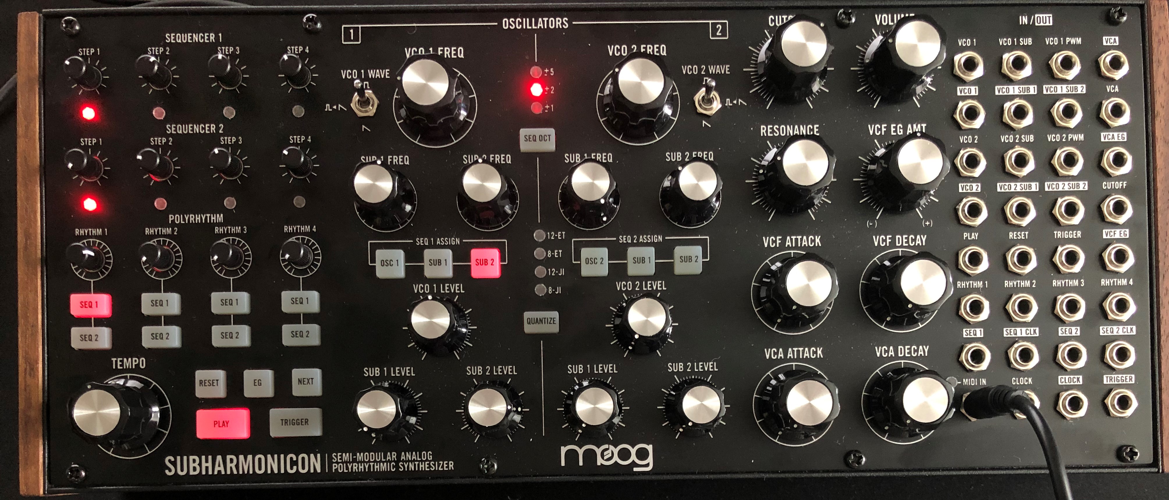

Hey guys,
I hope this is the right subforum for Subharmonicon related posts.
Could you please help me understand how the SH midi works?
Scenario 1: Midi Keyboard -> Subharmonicon all channel 1 ... no clock just notes
Sequencer 1 with simple 4 different notes
Play On
EG Off
Rhythm Seq1 on
VCA Decay minimal
When playing Midi Note seq 1 cannot be assigned to OSC1 only Sub1 and Sub 2
pushing OSC1 has no reaction
opening VCA Decay gives the sequencer 1 series as per knob positions
-> note played on midi keyboard is not "saved" with vco1
same applies to VCO 2
Scenario 2: Ableton Live -> USB-Midi-Interface -> channel 1
- start stops works and puts SubHarmonicon in sync
rhythm 1,2,3 and 4 doe not work as polyrhythms
survivel of the fastest. fastest rhythm will win the battel
can you please try and explain the behavior?
Kind regards,
Christian.
