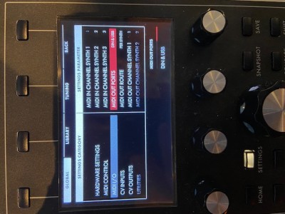

And as you can see in the 3rd Attachement the Midi i/o settings are perfect.
Any idea why the Moog obviously behave like that?

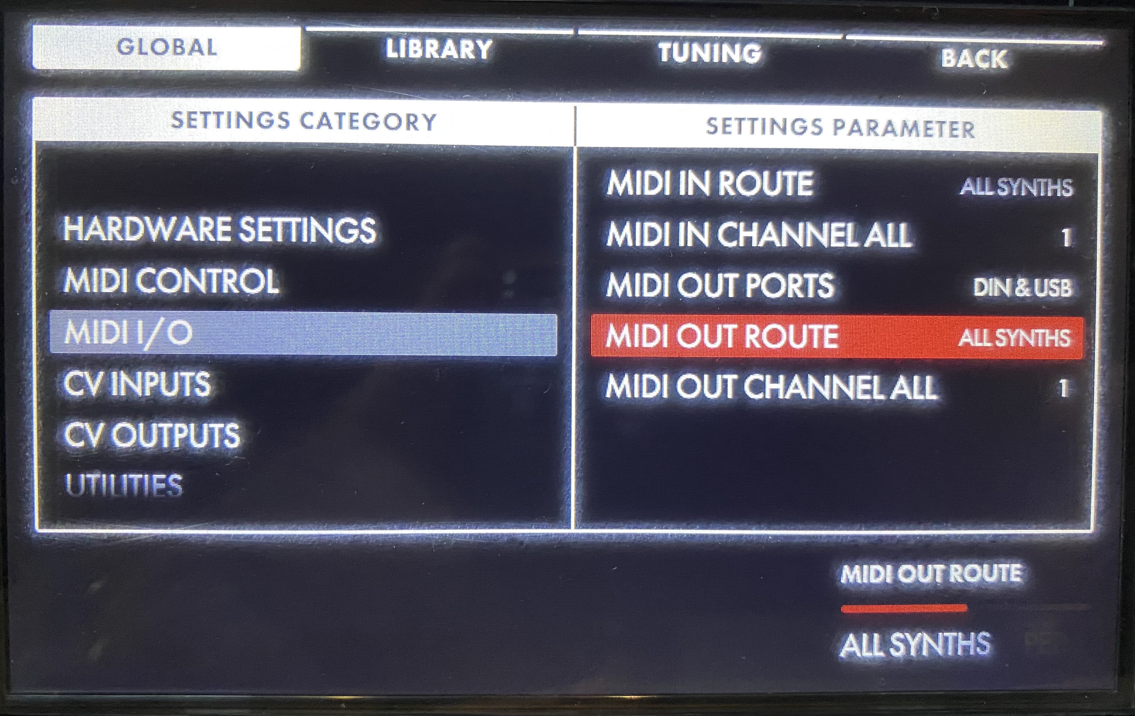

Re: 3 synthy can be controlled by 3 Midi cannels ?
Change to the following in the Settings.
MIDI I/O > MIDI OUT ROUTE > ALL SYNTHS
this should solve your problem.
You will still be able to trigger individual synths through their respective MIDI channels.

Sorry I have to disappoint you, the settings you suggested send midi only on channel 1, never the less which synth I have turned on.
For me was important to find a setup which definitly sends only midi on which that was predefined.
I think moog suggests it when using Midi rout in/out Per synth for different channels. Thats what it seems to mean.
BUT: It doesn't work that way.
As you can see in the pics above (the white displayed window in the Logic part - it's the midi monitor window), when using this configuration the moog sends - even if any synth is turned "on" in the keybord control part- midi Note on/off messeges out on all the predifined channels.
