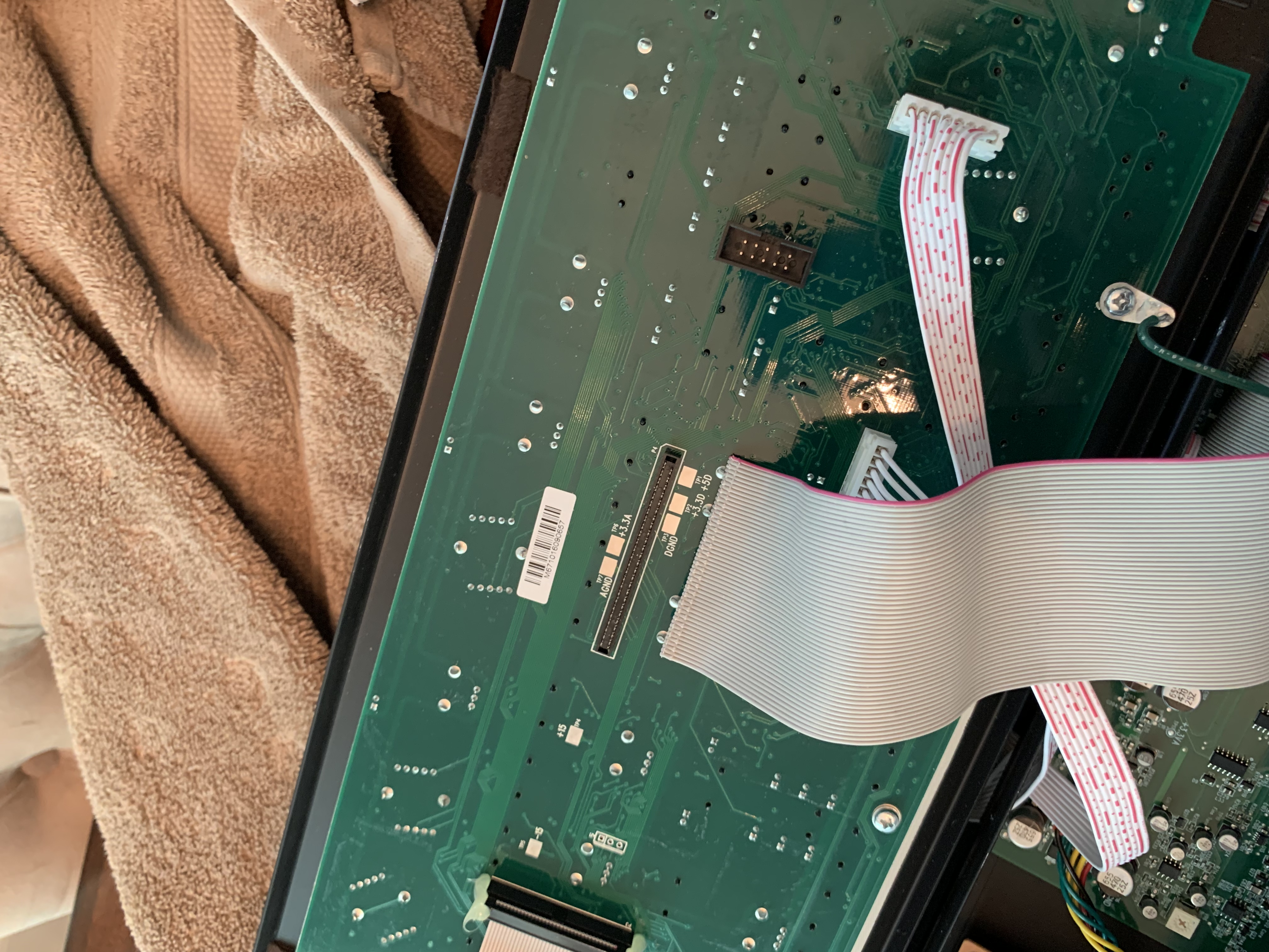

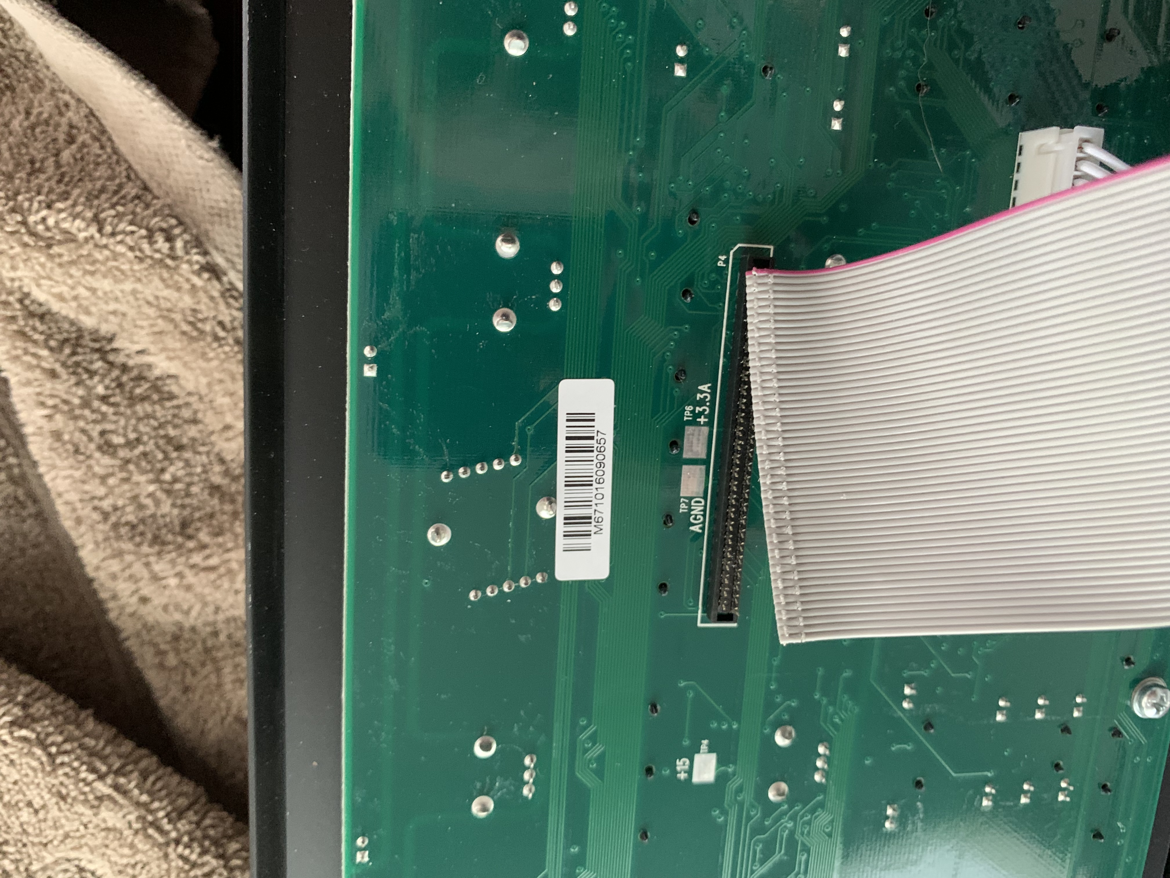

Would anyone be willing to give me some advice on how to reconnect this cable? The connector broke off. I have attached a picture. Thanks in advance for all your help.

It doesn’t necessarily look broken but cable pulled out of press fit crimp connection. Is there a cap/cover that went over it. If not I’d try carefully realigning it to the “v” piercing contacts and pressing down on the cable firmly to ensure contact with each wire inside it’s insulation.
If there is a cap/cover snap it back on to help keep the ribbon cable secure.

It seems like you should be able to purchase a replacement ribbon cable from Moog Support, recommend trying getting in touch with them.
