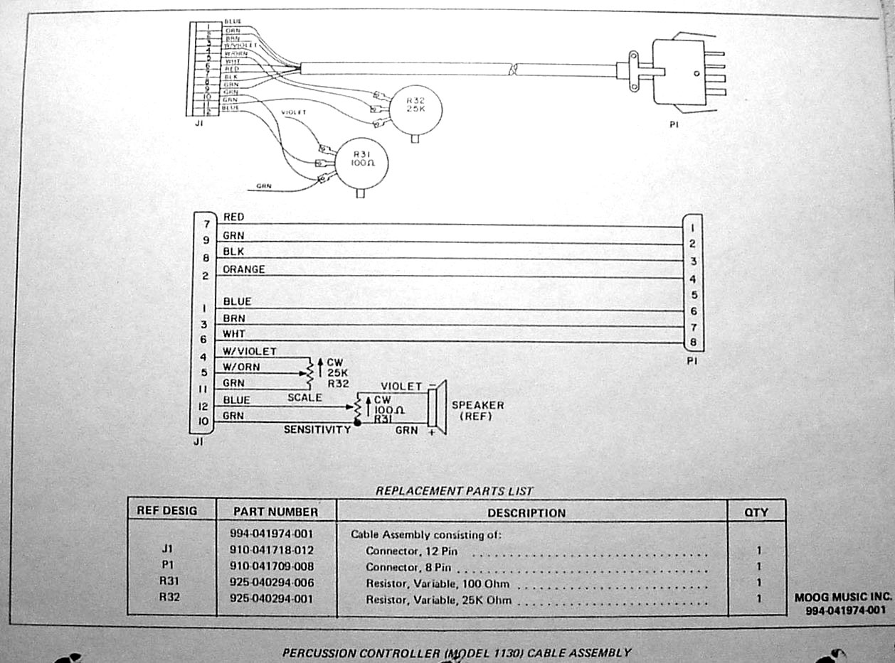

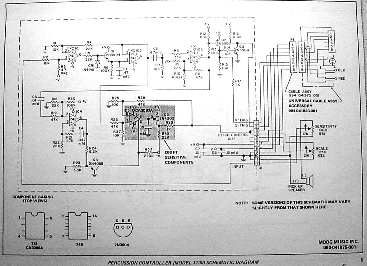

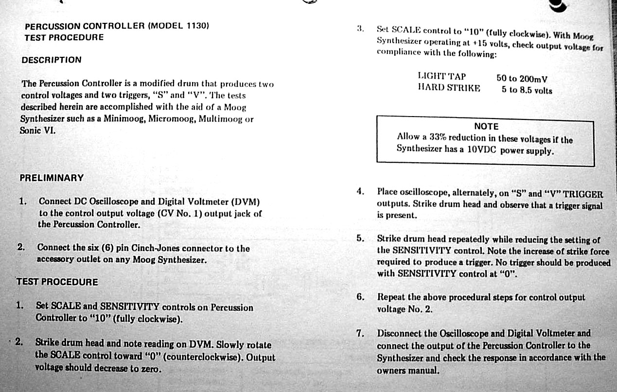

The Moog 1130 was supplied with an adapter cable which was used to interface the 8 pin cinch jones on the attached cable and then provide a 6 pin cinch jones, a couple 1/4 inch jacks, and a 2 pin cinch jones. The 6 pin cinch jones was used to provide power to the 1130 (or other accessory) which was plugged into the Moog synthesizer like Minimoog or modular. The 6 pin cinch jones also had an output for a voltage trigger (V-Trig). The two 1/4 inch plugs provided control voltage signals (CV), the main CV signal as well as an auxiliary (AUX) CV signal. The two pin cinch jones was the Moog standard switch trigger (S-Trig) signal. You can see this in the images below.
There is no direct Midi interface for the 1130 or other accessories. They are simple control voltage devices. You can certainly make your own adapter cable with a female 8 pin cinch jones and then add your own cables with appropriate connectors to provide power (+ 10 to +15 works in my experience), and then some connectors to break out the two CVs, and either or both the V-Trig and S-Trig. I have more information that is too big to attach to this post. Email me if you want more information.
