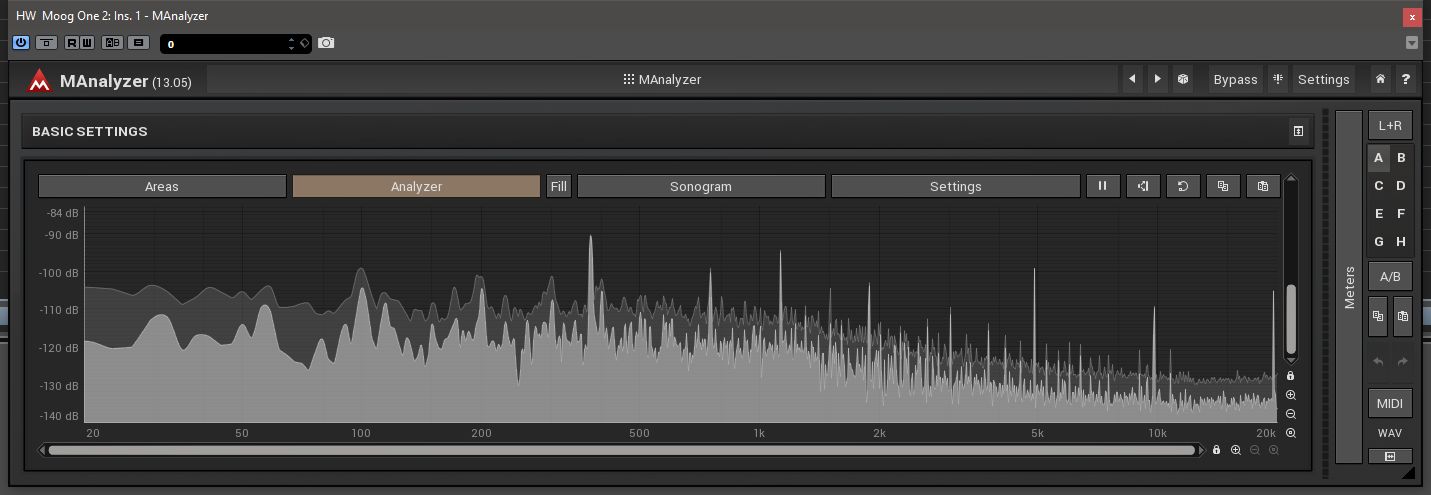

I was about to come here to make the exact same thread. I will give a more detailed reply later. One thing to consider is however the signal to noise ratio. The SNR is fine to me on the mainouts on my unit. The best position for me is 60%
However, meanwhile check out the noise of my sub outs
And nope, that's nothing from outside. I disconnected everything else, the powerlines are clean and no other unit behaves like this.
